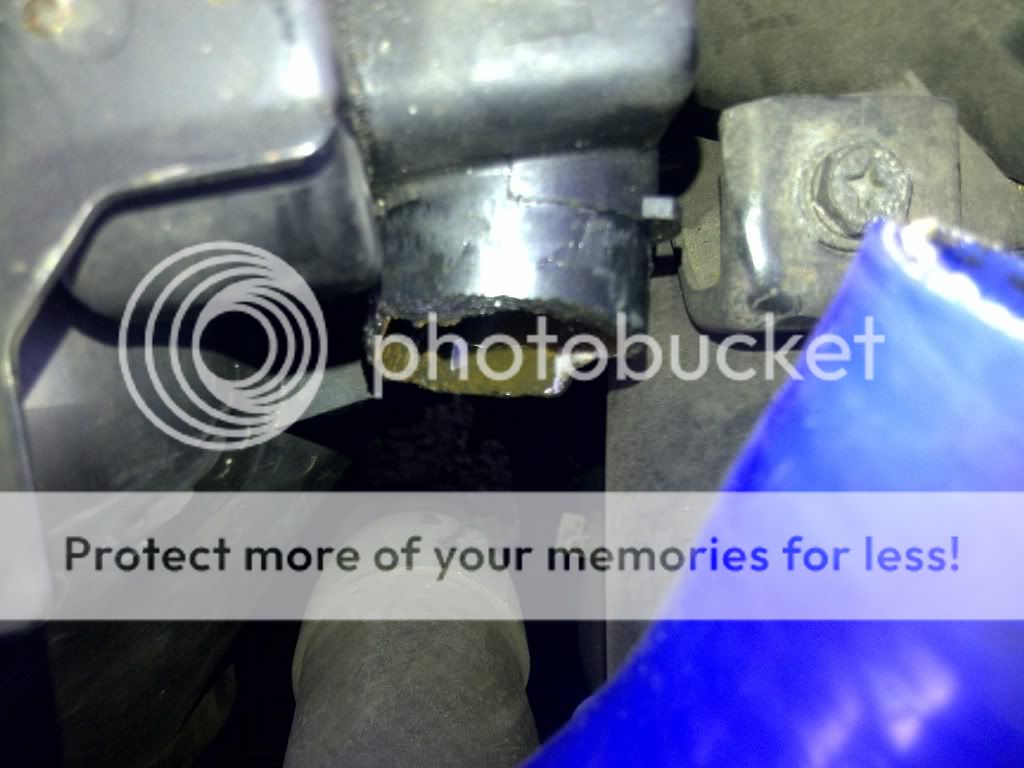

I saw a similar issue highlighted on a recent thread where the top connector on the stock rad had deteriate over time and eventually had gone brittle and broken away. The piece that's broken away on mine is still in the stock upper radiator hose so it won't be causing any dramas later on down the line

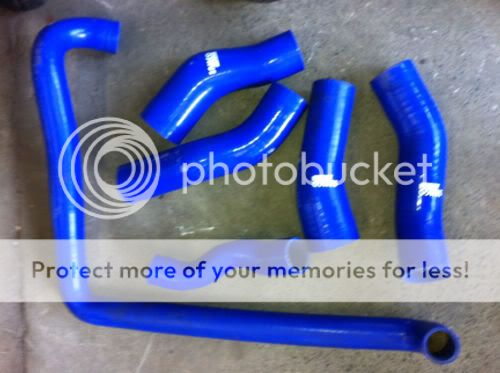

I was in the process of fitting my new SAMCO hoses, then figured that if I was going to have to replace the rad anyway I might as well hold fire on fitting the lower radiator hose (still need to fit jubilee clips obviously)
What I wanted to check was whether the dimensions (besides thickness) of the Koyorad/Japspeed rad were different to the stock rad and whether the SAMCO lower rad hose would still fit.

All the hoses will be fine. but you will need to cut the top rad pipe so it is shorter. The wider rad sits closer to the engine and kinks the top pipe.

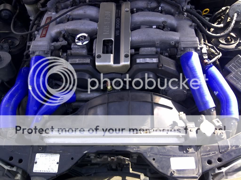

i got a koyo rad and blue samco water hoses and all fits perfect!:thumbup:

but still, good to know that the hoses all fit well :thumbup1:
