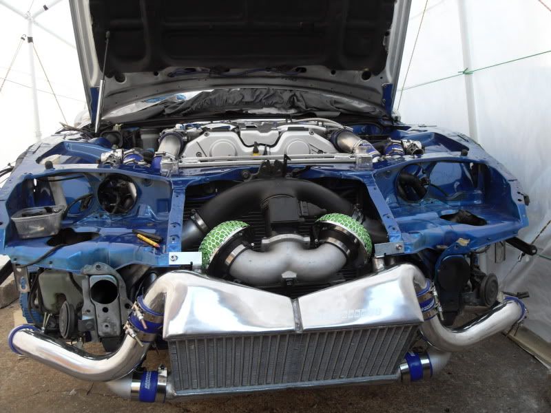

Same as the autobahn88 intercooler. Ive got one, made a nice noticable difference.
Yep ,well the Autobahn one, i was impressed with the quality for the price:thumbup:
Although i did mod the top mounting bracket to raise it up about an inch higher .
what did u mod .. as it looks the same as mine is now ...
but i see you have diffent bumper to me

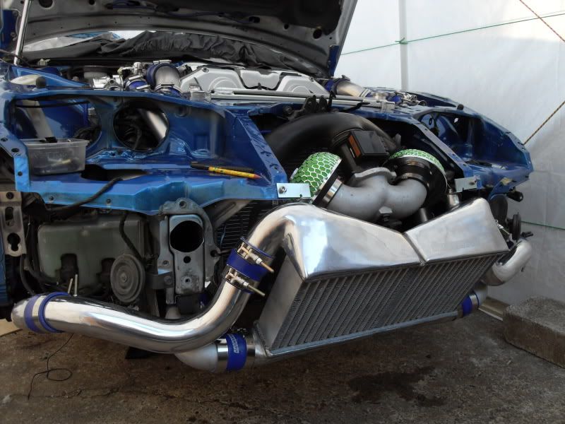

That pic was before being modded , i drilled new mounting holes an inch higher than the ones used but had to trim a bit of metal off the corners of the headlamp panels as the intercooler was gonna foul on them , just gave me a bit more clearance at the bottom as they do hang fairly low .
