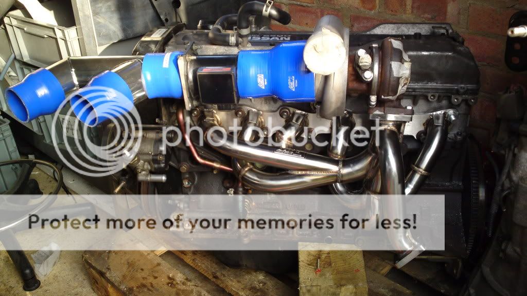

Ever since seeing these on single turbo converted GTR's I always wanted one, I think they look the nuts.
Now the Greddy pipe is rare and expensive so I started looking around for a cheaper option.
So I bought the ally twin pipe from Ebay and was for a VW Corrado?? And the twin Apexi kit is from an RX7, which i had to chop up a little to make it all fit. Well thats what thought any way....
With the afm bolted on as well it pushed the induction pipe length to far out of the engine bay and also the afm was to close the turbo so I am going to have to put the afm behind one the apexi's but then this pushes it to far right into the arch.....
So I have left this little problem for now and I will just bolt on a single induction pipe in the mean time. (The only easy solution is lose the afm and go for a G Link or Apexi D Jetro ecu)

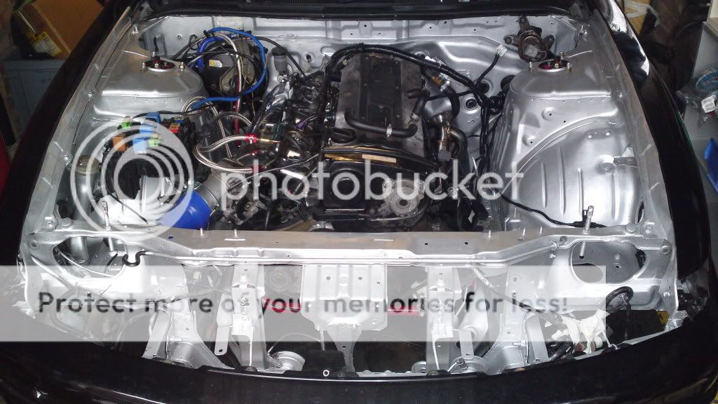

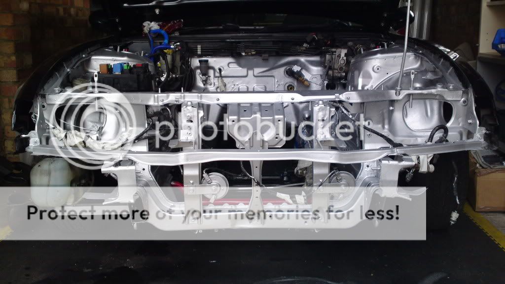

I gave the engine bay a fews coats of Por 15 as s14's do like a bit of rust!

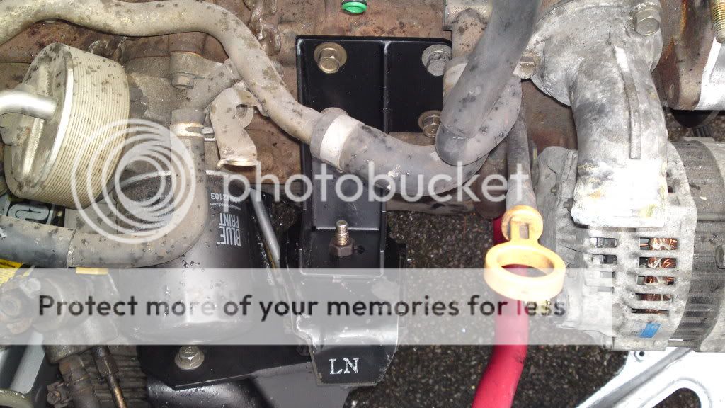

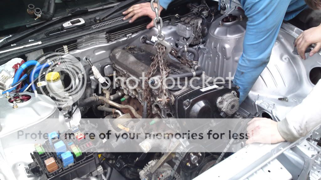

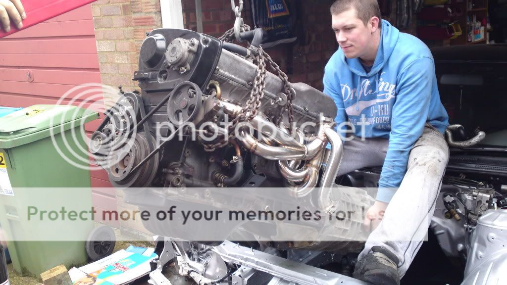

Right it was time to drop the RB in and hope my custom mount kit all fits as most RB conversions in the UK are done with the R33 front cross member and R33 engine mounts but this kit is supposed to allow the RB to sit lower and a little bit further back in the chassis and I also had a nice set of s14 Nismo engine mounts which I wanted to use in the build.
Easy does it, with a little help from Jay20 off SXOC!
The brackets line up 100%!!!
Gear box bracket lined up aswell.
Done!

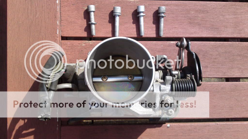

Q45 90mm throttle body
I decided on this over a custom jobbie as it retains the throttle sensor and only needs a little rewire as there are 2 plugs on the wiring loom to link it all up on a series 2 rb25det.
On a series 1 rb25det the throttle sensor just plugs straight in, something I didn't realise until I had a spare plug and was wondering where does this go??

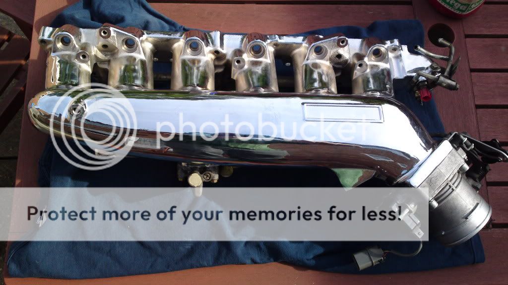

The next step was to transfer all the std intake manifolds pipes, breathers and sockets onto my new Greddy intake manifold.
Notice the size difference but there is a good weight saving also!
Now this is where some of the cheap Greddy copies can come unstuck with the pipes not lining up and the quality of the threads can cause poor fitting and leaks etc. Luckily this was not an issue and everything bolted on as it should.

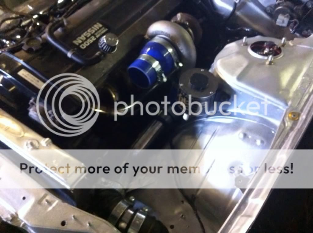

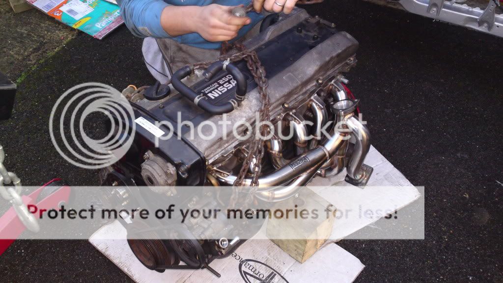

I have clocked the turbine housing on the Greddy T67 so the oil return now faces down and the oil feed is now up in the air. I then bolted it to the manifold and measured the gap from the exhuast housing to the bulk head so I can start working on the custom down pipe.

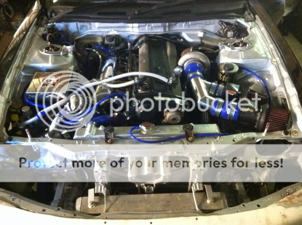

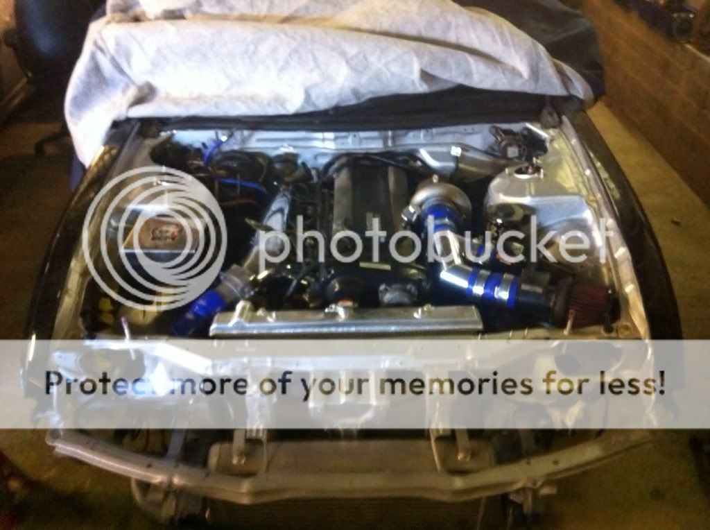

I also completed fitting the custom intercooler pipework. This was trickier than first thought due to the size of Q45 throttle body and custom intake manifold which made it very tight indeed.
I have only linked it all up with silicone atm but will need to get it all welded together when I start running some big boost through it:yes:

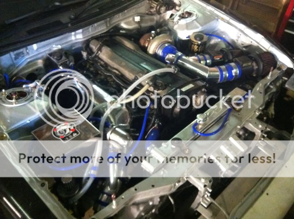

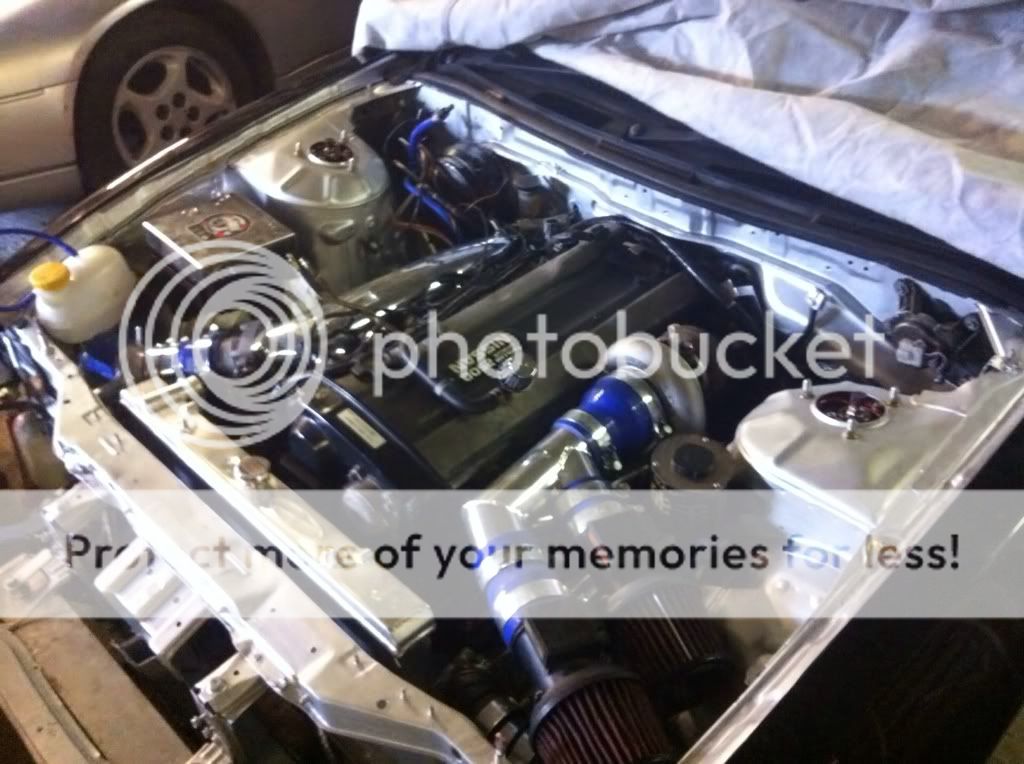

I then got to work on the twin Apexi intake kit removed from an Rx7 andf the only way to make it all fit was to remove the apexi elbow joints and replace them with 2 Z32 AFM's ( thanks to CoolQ for selling me his spare!)
I am really pleased that i managed to fit them and I reckon looks pretty tidy with the Greddy T67?
I quickly dropped the rad in to make sure there was enough room to fit the electric fans as the viscous has now been dumped.

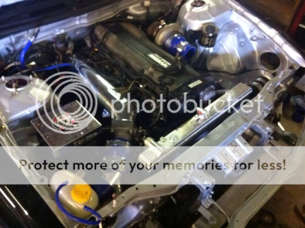

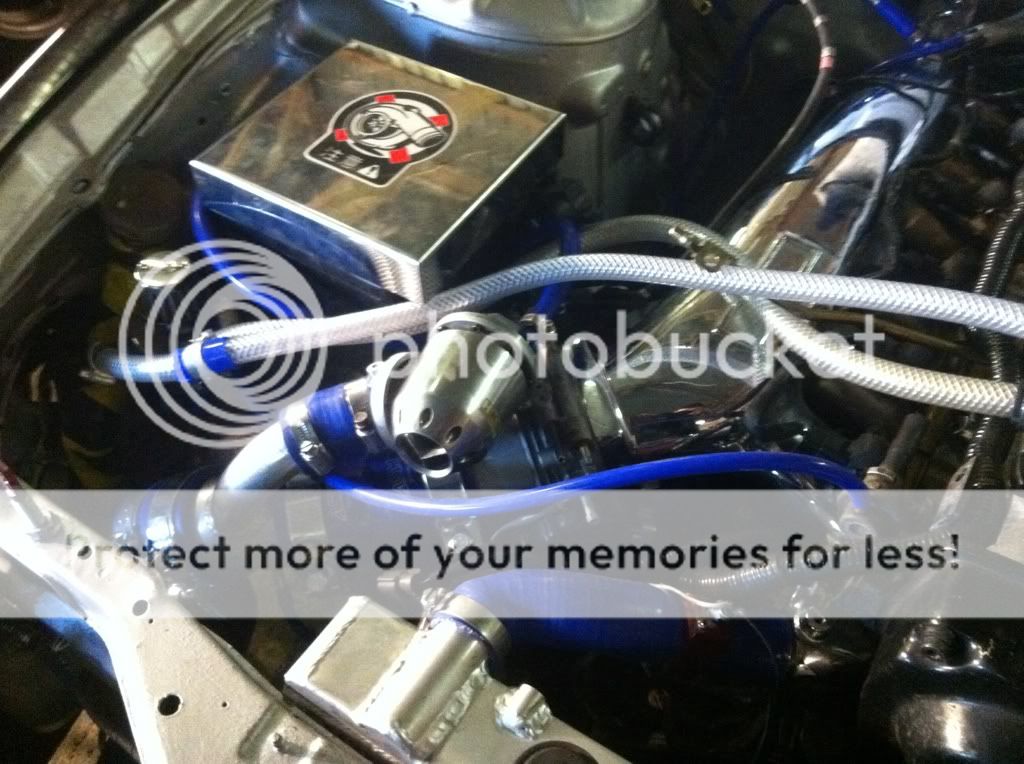

I then went to work on sorting the HKS BOV which again caused problems as space was again very tight on the intake side of the engine.
I had to buthcer the last remaining piece of the SR20DET FMIC pipe work to make it all fit and after much grinding, cutting and swearing it all squashed together:hammer:

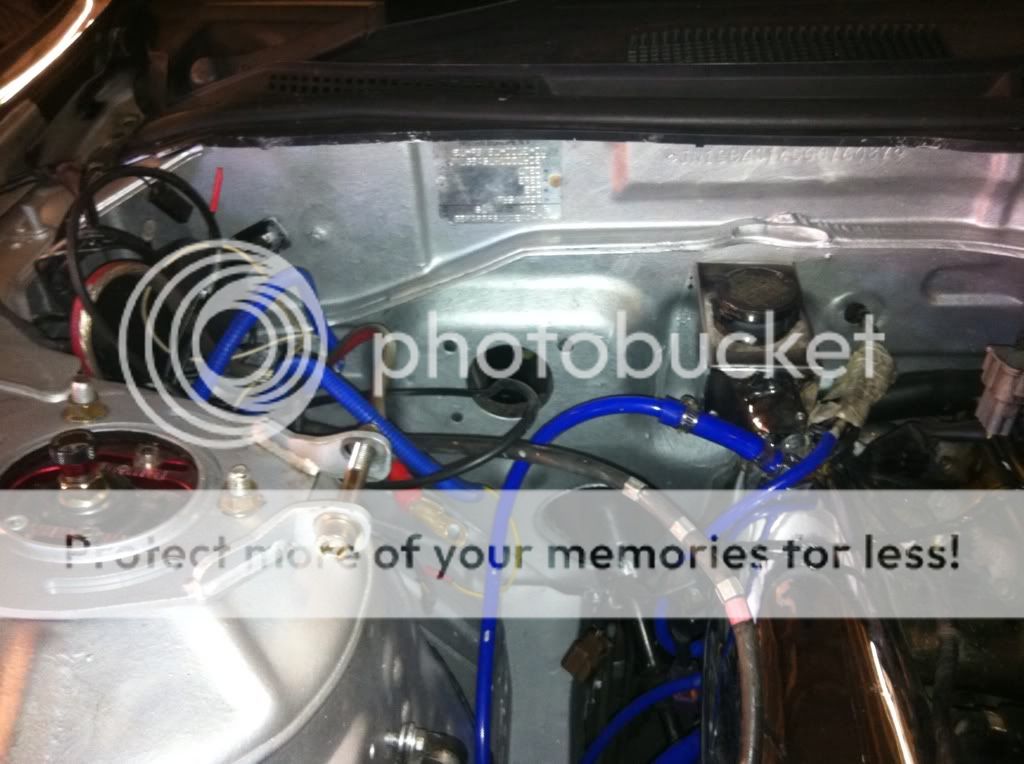

I finished the day by plumbing in the oil catch can and alloy rad but I now have no space for the coolant overflow bottle:confused1:
I then sorted the throttle cable by rotating the Throttle Body 180 deg which made the cable the exact length, result!!! I thought this was gonna be a real pain in the ar*e
