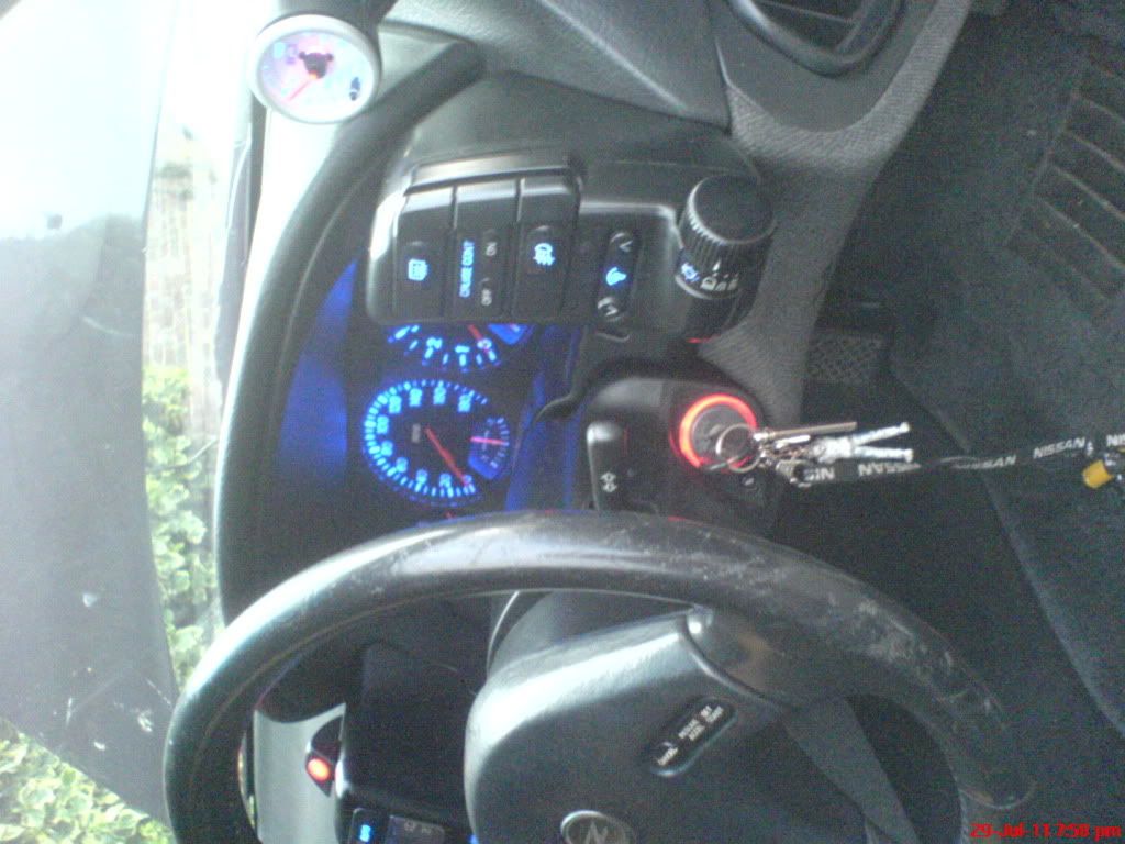

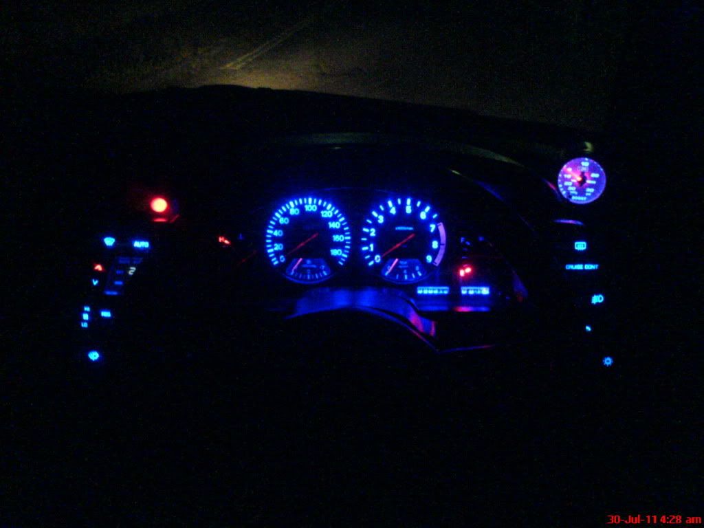

love the Led conversion, really put a smile on my face for the 3am drive to work this morning lol.
haven't wired the doors in yet but love the rest,

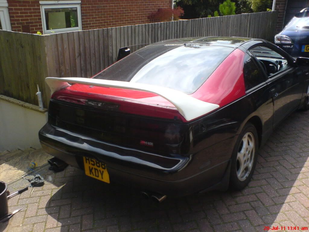

and a quick pic of spoiler, cant make out in pictures but fitted a rear stut brace too. :thumbup:
Looking nice there Ash, i have to say though that you may need to rotate the rear 501 leds as your temp and fuel gauge are not lit as they should be. The extra led strips inside the dash are wired to the bottom 2 screws so light anyway, i have a feeling that although bench tested, the 4 501 leds in the rear may need turning 180deg, then it will be spot on lol
ah its not that bad at night isn't really a problem, but i was wondering if it could be made brighter ill give it a go thanks.
