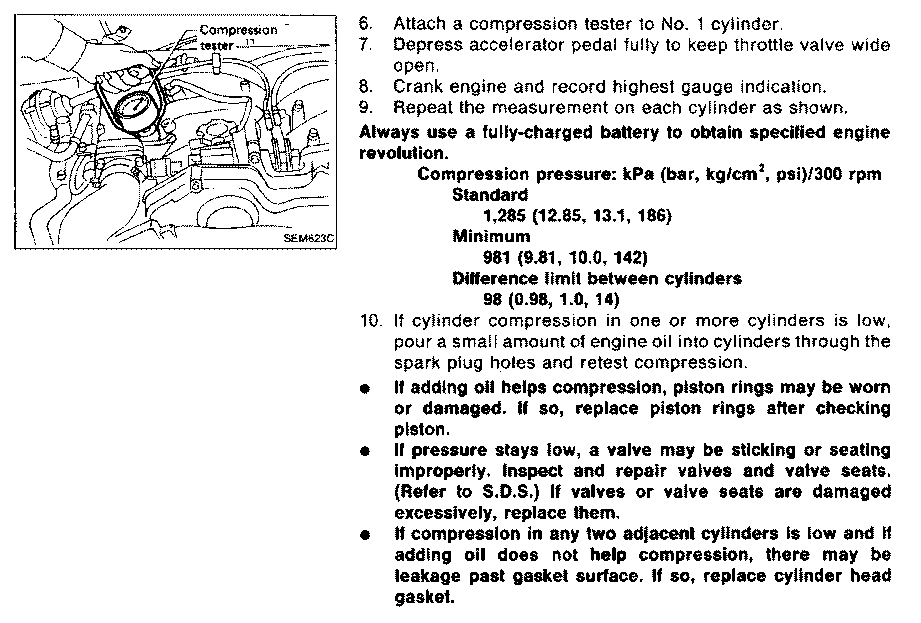

well to give you some idea,
Nissan service manaul
186psi is normal (just came out of the factory) and is good
145psi is minimum (they advice checking the valve seats and piston rings)
with no more than 14psi diffference between cylinders.
185psi is normal (just came out of the factory) and is good
100psi is shonky and could detonate at any minute
60psi... are you nuts, stop driving the damn thing!
id start planning for either an engine rebuild, or replacement.
