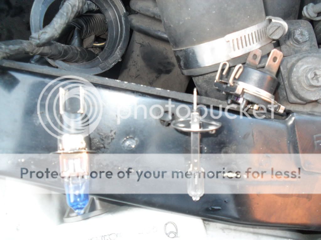

Yeah these ^^^^ (# 501's) are what I tried to fit from Halfrauds' and they didn't fit
These are the bulbs fitted to the Shortie' (it's not a HID bulb by chance is it?)
They blue bulb doesn't slide out either as it's wired in place (I broke one trying to do a one for one swap with a 501 bulb)

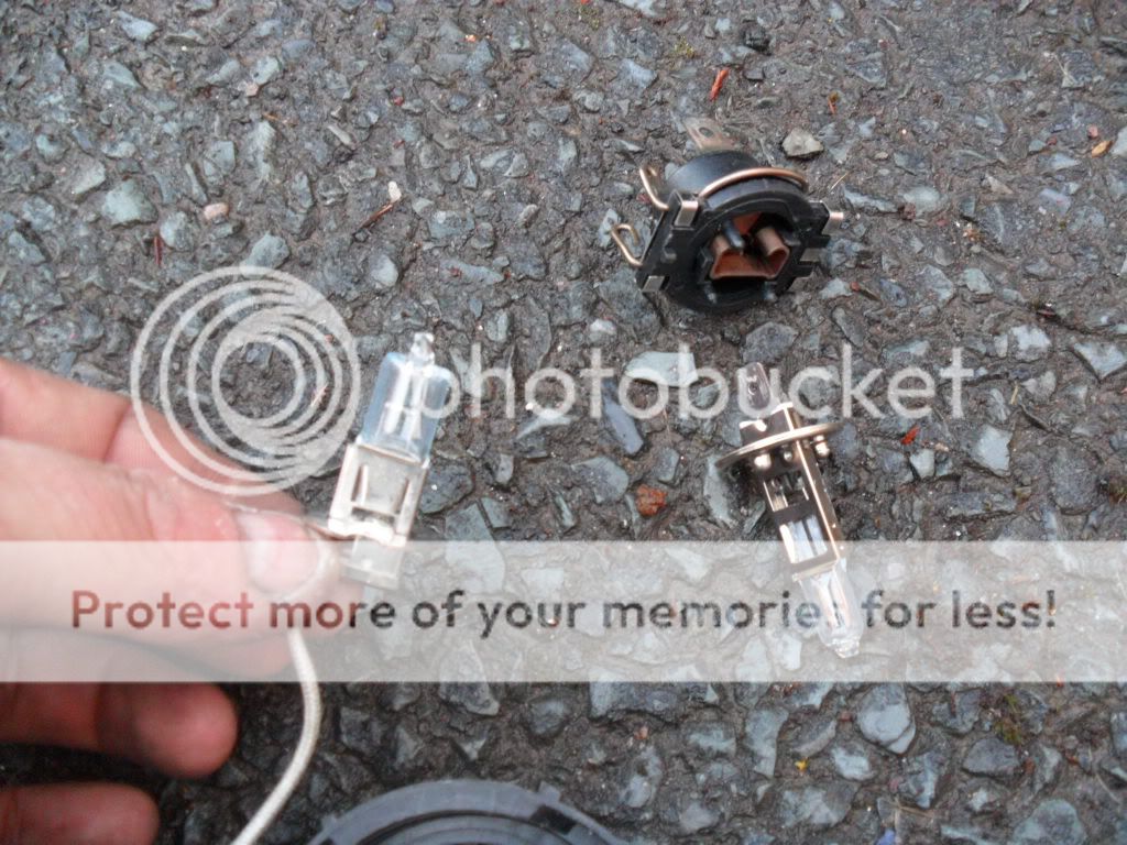

and these are the bulbs fitted to the UK spec LWB (# 501 on the left)
ok, unless im mistaken from the pictures I think you meant dipped beam, rather than Sidelights ? (The sidelights reside in the Foglight enclosures in an Import, and in the Indicator housing in a UK car)
The Dipped beam is a H3c in an Import, and a H3 in a Uk car. The difference is with how it earths at the connector.
H3c are very difficulty to find at a typical retailer, avilable online or at more specialist retailers. Or you can fit a regular H3 bulb and solder on a second lead onto the metal base with spade a connector at the other end for plugging into the stock connector.
Edited by Yowser
H3c are very difficulty to find at a typical retailer, avilable online or at more specialist retailers. Or you can fit a regular H3 bulb and add/solder on the earth wire.

so in that case my Shortie's sidelights are working fine, as do the fog lights
So I need to replace the H3c bulbs of my dipped beams as they are obviously pretty crap then
so is the larger bulb (right with 3 pins) just for full beam?

yep, source a H3c or modify a regular H3 to fit.........but by far the best option is to fit a HID Kit !
Available from about 30quid, a h3 6000k kit will do the job perfectly. (dont need a h3c kit for HIDs on imports, just a h3 kit due to the way the connectors work).
Its a straight plug-n-play fitment and it transforms the cars lighting.
and the 3pin one is a H1 for the Full beam, yeh.

that's one blown bulb and a pretty crappy bulb now changed
bit of solder and a spade connector sorted it, all lights working properly now, but I think your right, HID kit going on shortly I reckon
