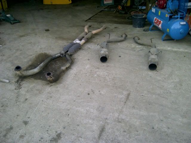

It was MarkyB's old system, I thought just the rear boxes on this picture would fit onto my standard setup... Obviously I was wrong and needed the complete thing? *wonders*

If you have enough length, i would cut off both flanges and get a coupler tube with a couple of U clamps on each, job done.
Before i went completely stainless, i bought 2 back boxes off ebay and had them fitted in with a coupling tube and worked a treat.
