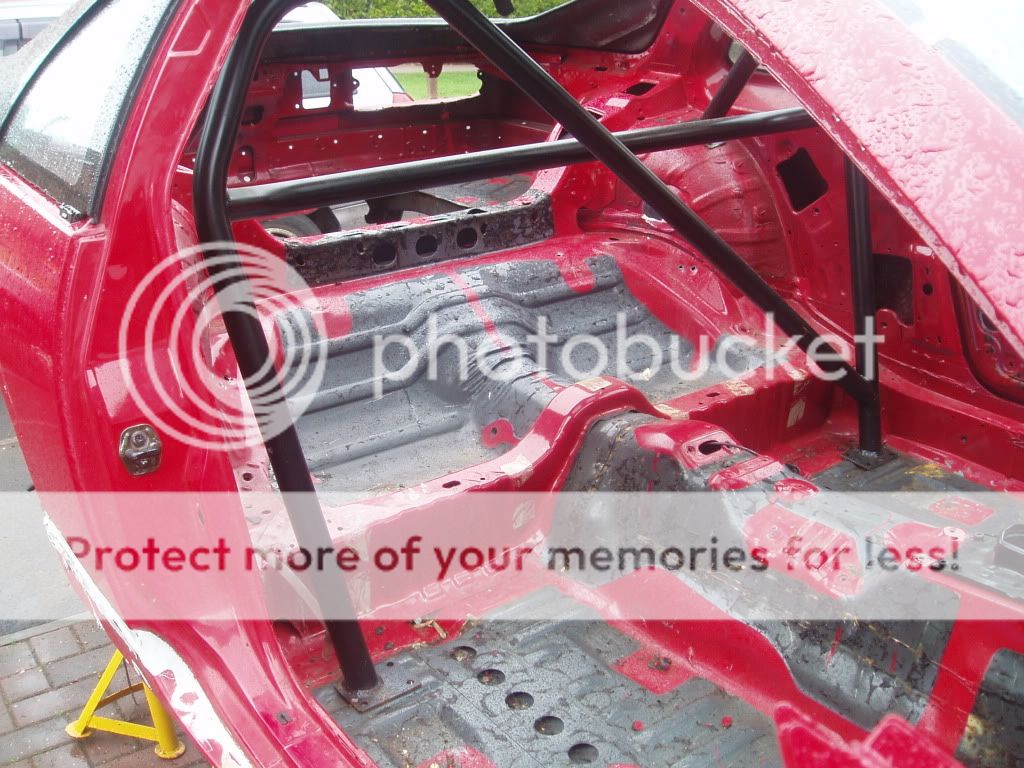

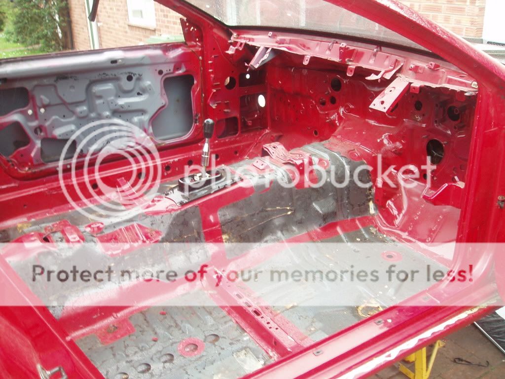

have made some progress on the old girl, pretty much everything that could be stripped has been, and she's almost ready to go to sand blast
all excess brackets etc have been removed, now getting started on the last few where the dash used to be, then its just a case of subframes off (they're getting blasted also) and engine on a stand....jobs a good 'en

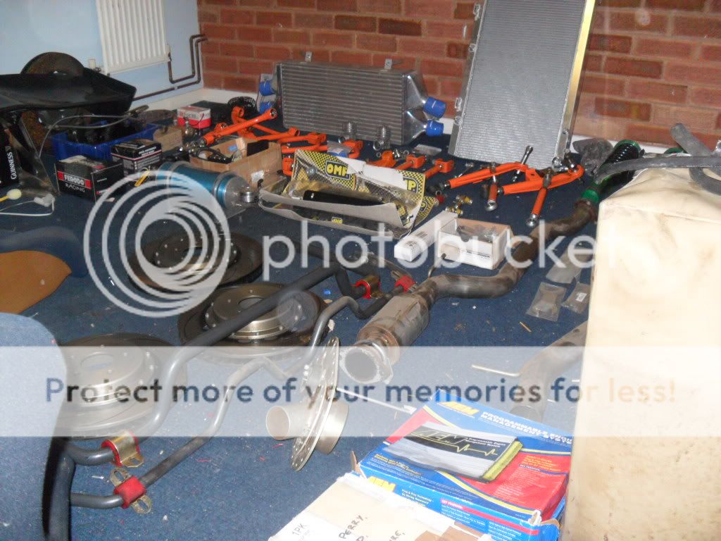

Typically the attic space above the garage as well as the garage itself; that I had cleared out, has now suddenly filled up with boxes full of car parts....

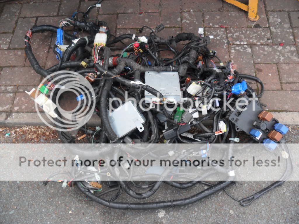

old looms out ready to be used as a template. Dave Rowe (see this months Total Nissan mag) would appear to be the man for the job
and have been playing about with different locations for the oil cooler and have settled on building it into the front bumper, forward of the fmic

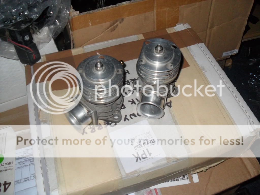

-Twin ARC bov's *from BNR34 GTR, now being mounted on custom intake hard pipes*

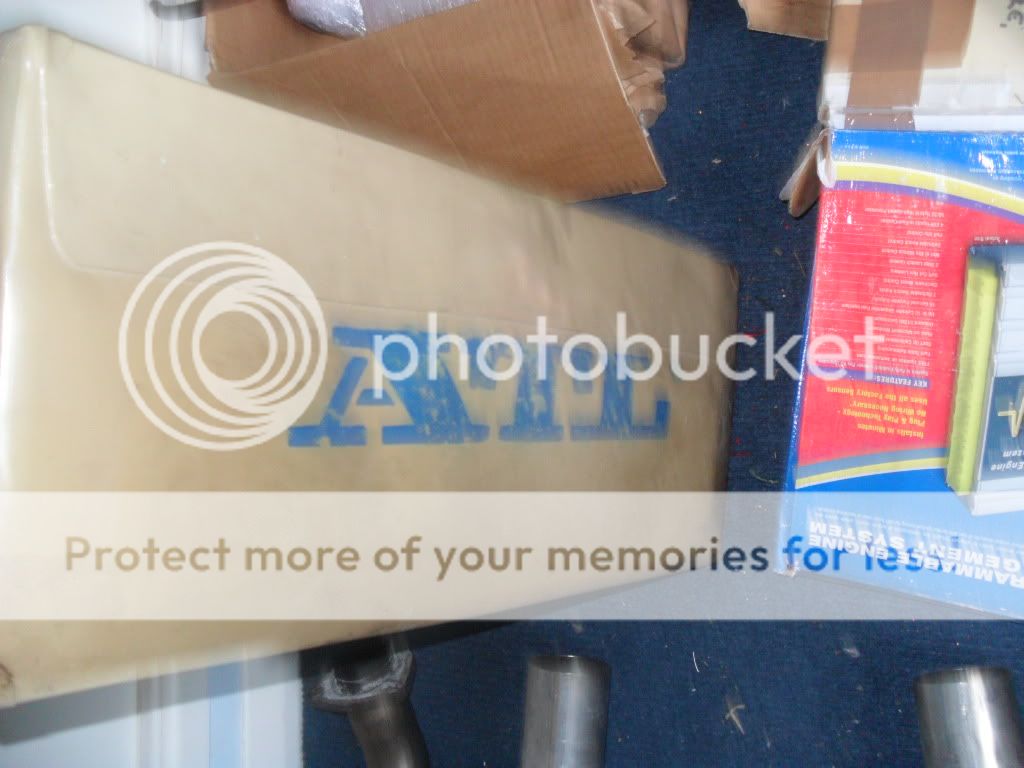

-ATL fuel cell
-ATL 1.5ltr swirl pot

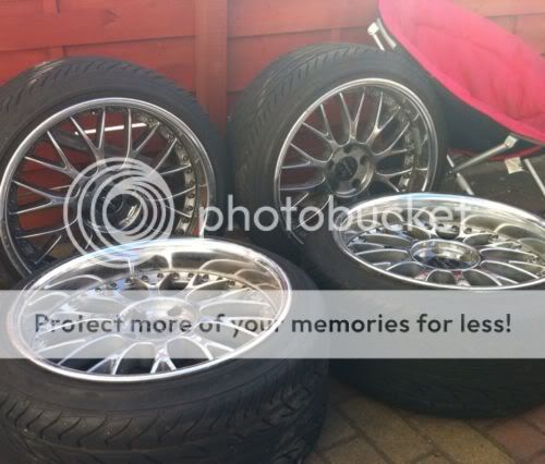

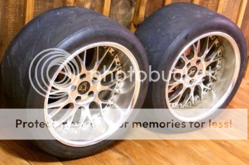

New Enkei's (9J & 10J) going for refurb (white centres)
The 9J's will be kept for spares and the 10J's are going on the front.
New rear fenders are planned, so just bought these SSR's, which are very similar to the Enkei's, from Dino (Japan Dyno) 11.5's should fill the new rear arches out nicely...(again refurbed chrome with white anodised centres)

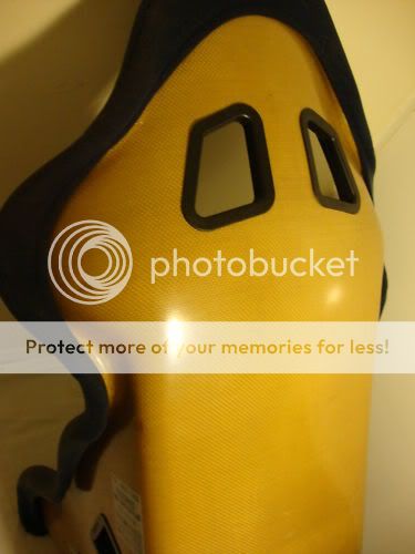

As some scumbag has just robbed my previous set of Sparco's I've just bought a nice Sparco kevlar with OMP rails

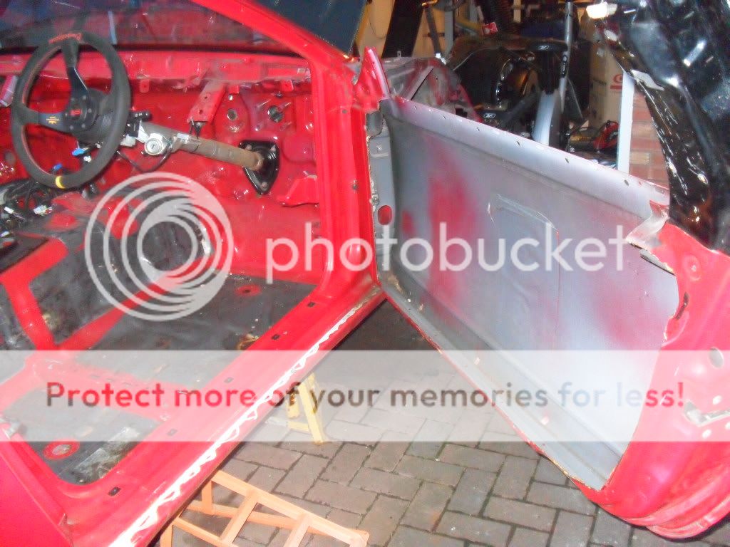

Stripped
I stripped the door skins, but still too heavy and a tad too much flex so its gonna' be either Escort Racing FRP doors (which are for SWB so would need a bit of work) or Final Konnexion FRP doors (which don't have a B pillar so both SWB & LWB)

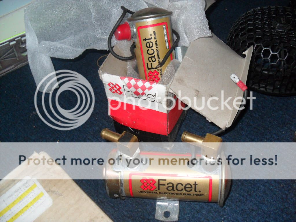

Do you know what flow rate your new fuel pump is mate or are you running it in conjunction with the existing?
After much discussion with a number of guys I opted for this setup (which is very similar to the Group N rally car that the fuel cell came from.
2 x Facett Red Tops as lifter pumps, feeding an ATL 1.5ltr swirl pot.Titan Motorsports have recommended that I use a Fuelab Prodigy Fuel Pump rated at 140GPH/1300HP and a Fuelab 818 filter with a 75 micron stainless steel element, this filter I have been informed will support 200 gallons/Hr, so well capable for my needs
The Facet pumps are spec'd (per pump) as follows:
Part No: RTW506
Spec: 'Competition'
Pump: (480532E)
Voltage: 12v
Earth: Neg
Pressure: 6.0 - 8.0
Flow rate (US Gallon/Hr): 40
Dry prime:
Height in mtrs: 0.6
Thread size NPTF: 1/4
Operating temp: -60C +43C
Power range (BHP): 200+

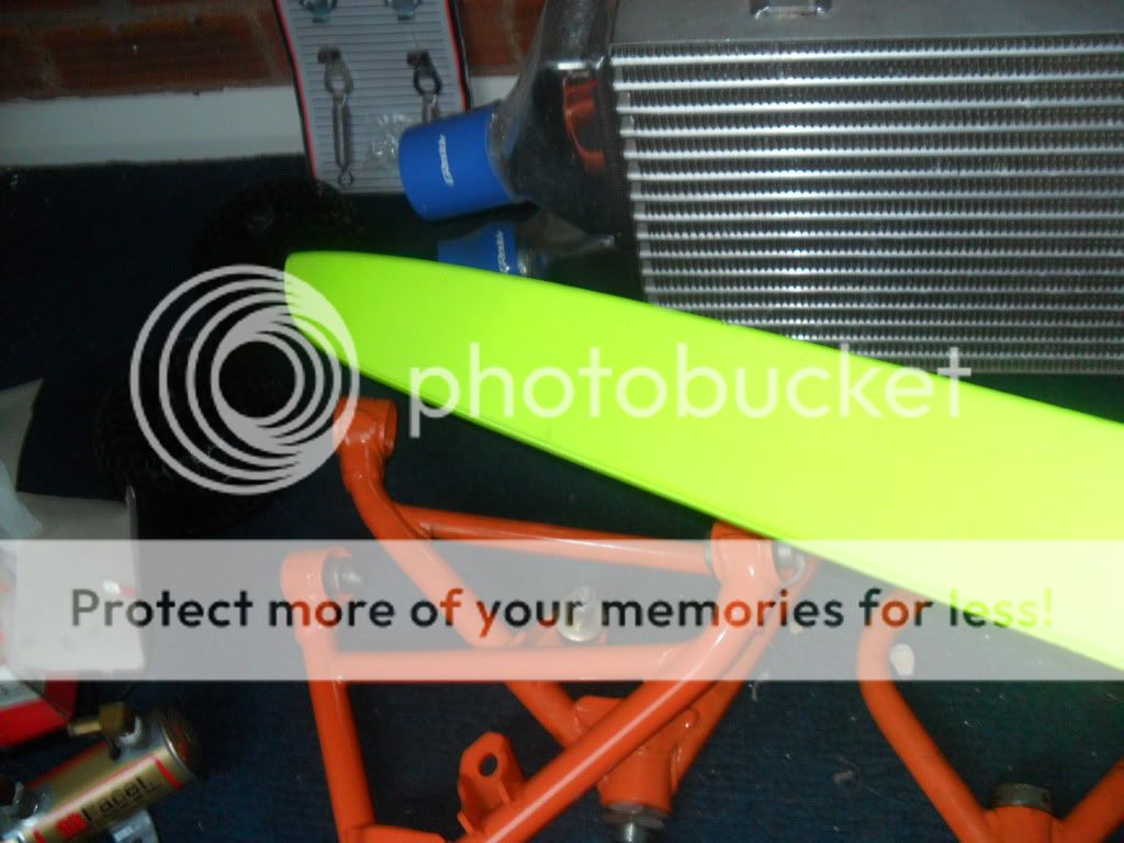

This is the colour that I've setled on....
it's a flat matt lumi yellow, that will contrast nicely with the bare carbon. Very distinctive, so ideal for advertising my new company name, logo and sponsors...
Ok fella, reason i asked was ours flows 255lph which is bloody powerful in flow terms and is often used as upgrade by others.
I know kirbz was gonna run a 2nd one of these to the existing in order to support 100bhp, yikes!
