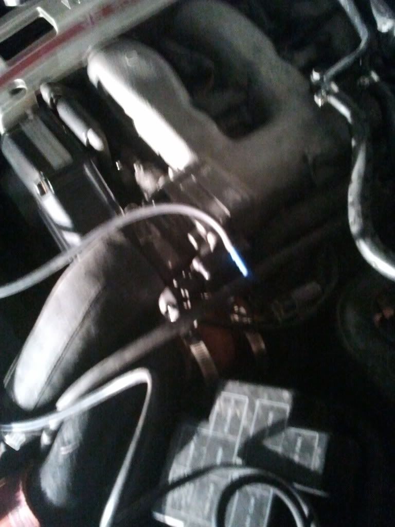

So i have fitted my hks dump valves ( on hard pipes ) but they dont make any whooosh atall at first i thought it was becoz i didnt remove the recircs , so i have now removed them and bunged up the wholes . the only known mistake i did makke was i didnt bung up the small vacume pipe off the top of the recirc , i am going to do this tommorrow , but i cant see that stopping them making a noise !!!
here are a few pics . also wasnt to sure what vacume to T them into but am pretty sure i got it right >>

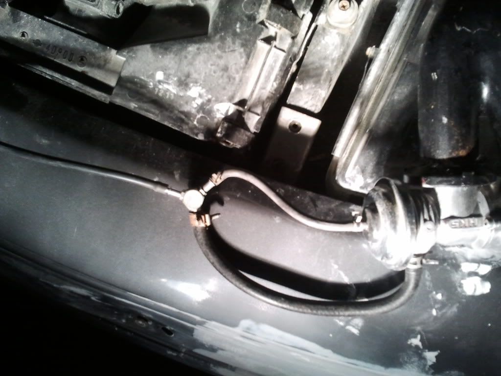

i removed one of them again to show the vac set up, both vacs of the valve go into a T , then the line takes them to the inlet

ah, if its the SSQ version, then its dual chamber and has no adjustment.
I cant see your pictures, im currently on a shitty gprs connection, usually you would just use the vacumn pipe feed that the stock recircs use, but thats when fitting them in the stock recirc location where the vacumn pipe is right there.
Edited by Yowser
yeah mate , its hks super blow off , could using the wrong vacume line cause it to make no noise atall ?? surely there wud be something ?
