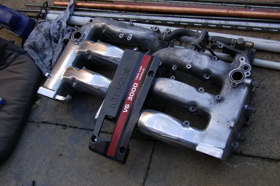

I painted the plenum on my TT when I took the engine out, but now I dont like it lol. So removed the plenum off my spare engine, did the water bypass and started polishing it up. After seeing recent plenums such as dazvert's and groover's I thought it was the only way to go :rockon:
Its a long and painful process but I'm getting there :w00t: takes forever :lol:

I have no regrets about starting it.. I figured it would suit the overall style of the car (with the bonnet up :lol:) Only thing is, now I have to get it finished before I can carry on swapping my NA out for the TT... unless I put it in without the plenum but I guess its all easier to fit together with the engine out.

well, i must be doing something wrong then, because i started, and ive been going at it ages and i cant see to get past the caked dirt yet, using 240grit sand paper.

Well done Baz, its a hateful job polishing the plenum!! It was made worse for me doing it in my car port over chrimbo in minus 15 ball numbing conditions, mine really needs doing again as its not perfect, the hardest part is the final mirror finish!!! but you will get there mate
well I found an orbital sander in the garage and some 60 & 100 grit sandpaper for wood :lol: works a treat getting the rough texture off. Then a good scrub with 800 then 1200 to finish before the final polish. :ohmy:

cheers Daz I finally got round to doing it see, I cant wait until its time for the final mirror finish!! just seems to be taking forever getting the texture off :cry:
I found this works well to get the casting off the plenum
http://cgi.ebay.co.uk/PAINT-RUST-REMOVAL-POLY-WHEEL-power-tool-bit-/400213757852?pt=UK_Body_Shop_Supplies_Paint&hash=item5d2e994f9c
Then this to get a smooth finish, available in B&Q much cheaper than anywhere else i could find on the net 97385_P?$p$
Then one of these, before moving on the the polishing stages
http://cgi.ebay.co.uk/100MM-SCOTCHBRITE-TYPE-BUFFING-DRUM-METAL-POLISHING-/350261217589?pt=UK_BOI_Metalworking_Milling_Welding_Metalworking_Supplies_ET&hash=item518d320935
NB i wouldnt use the first whell above for the throttle bodies :no:
The throttle linkage and springs can be started from the sisal mop with brown bar, no need for sanding, apart from the edge that shows when the throttle cover is on.
