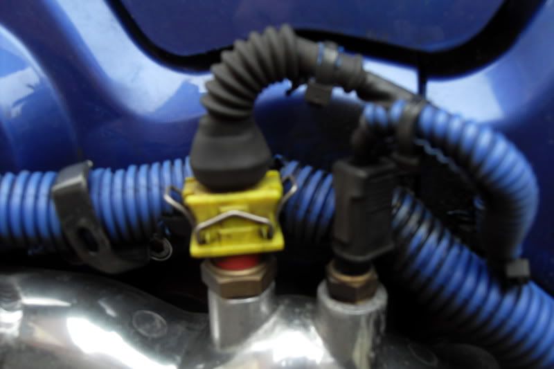

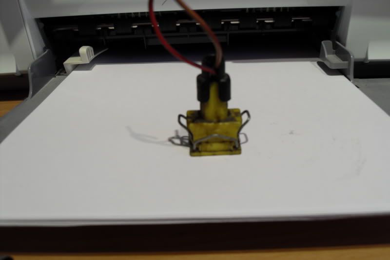

anyone know where i can get the yellow connectors from on the wiring loom? definatly need to try and replace the temp sensor and there is a yellow one at the rear of the pkenhum on the passenger side, both mine are loose and have metal retaining clips missing

Go to the scrapyard and get an injector connector of a vauxhall , they,re yellow, the alighnment ridge is in the wrong place but file the one of your sender and it goes straight on .
A good few years ago i replaced all my engine loom connectors ( the injector style ones ) with grey off a volvo for the AIV , Yellow as above and black from Fords for the injectors , cost me £2 for a hand full of mixed ones , worked a treat.
