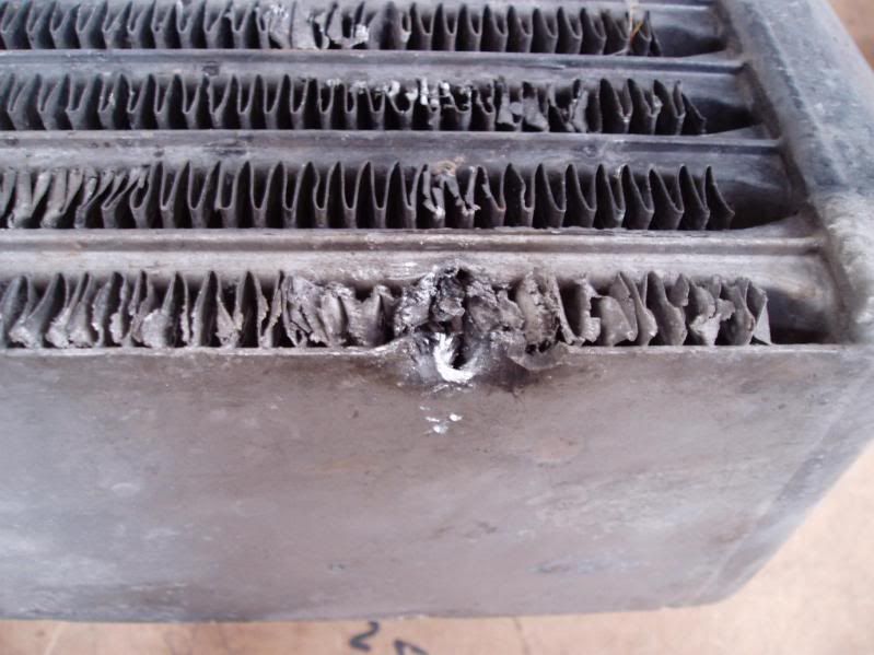

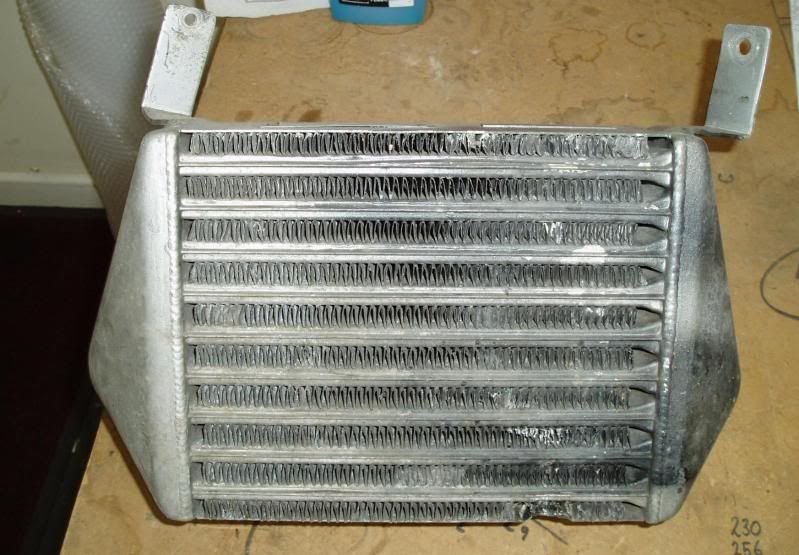

ARC Intercooler holed by a wood screw

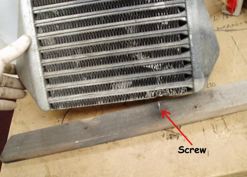

Brillomaster mentioned yetersday how he had suffered from someones previous bad work that came to light when having a chip upgrade, the boost leak was bad!!!! seems someone had used a bit of wood to add some firmness to the bottom of his 99 spec bumper due to missing fixings, unfortunately one of the screws had pierced the intercooler.
Took some picures and thought they may serve to keep all owners alert to taking care when drilling etc. on zeds.

Yes cool, actually I think the screw was in fully at some point and was sealing the hole, but as alloy is soft over time the weight of the wood hanging of it has worked the screw out.
