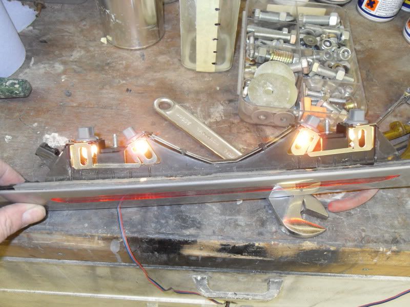

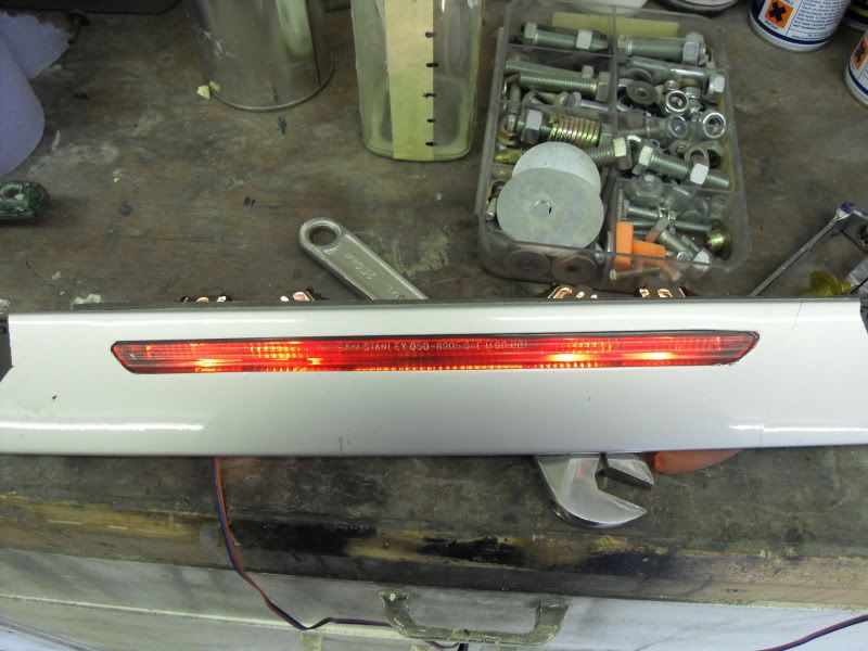

I,m going to be fitting a new black perspex tailgate trim with the brake light in , now i prefer like the look of a led brake light compared to the crappy four bulb Nissan one which when lit looks patchy cos of the bulb arrangment.

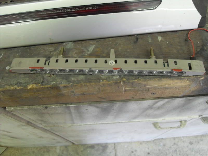

I got a damaged led one off a Merc and removed the rest of the broken red lens

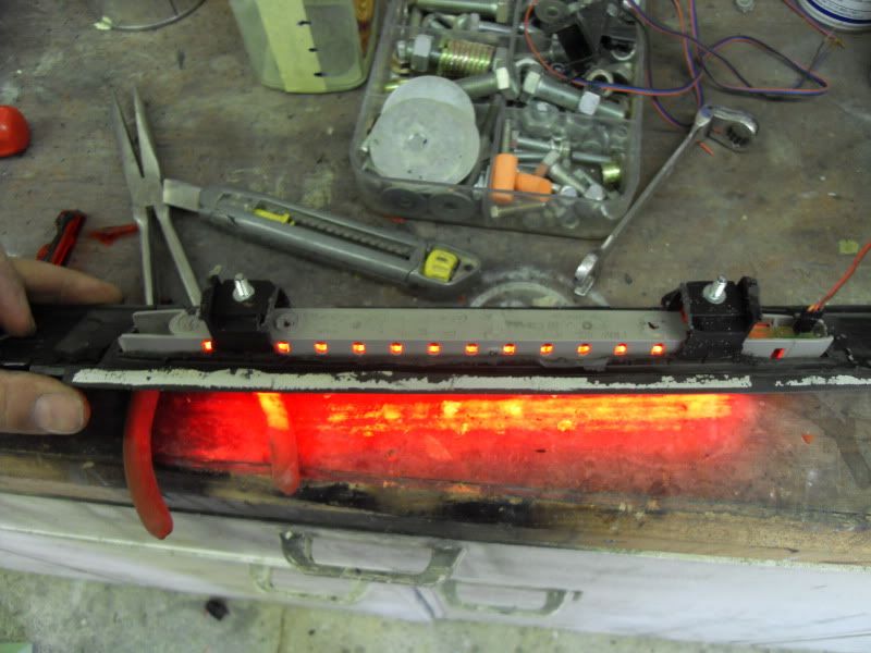

Tried it against the remains of my old trim to see if it could be fitted and it looks like it,ll fit with alot of trimming

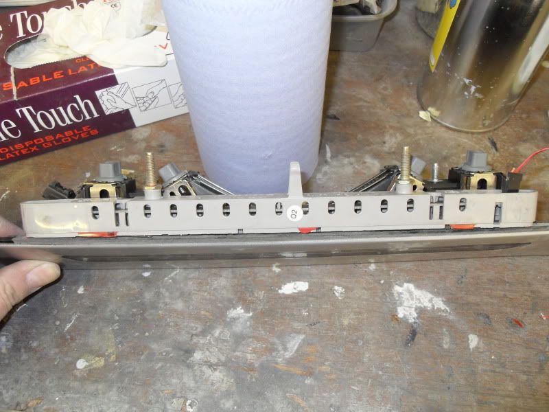

The tailgate trim has two mounting bolts where the light is so i wanted to keep these intact so i removed everything around them and the red lens that,s inside the trim , a bit of fettling with a belt sander and in it went

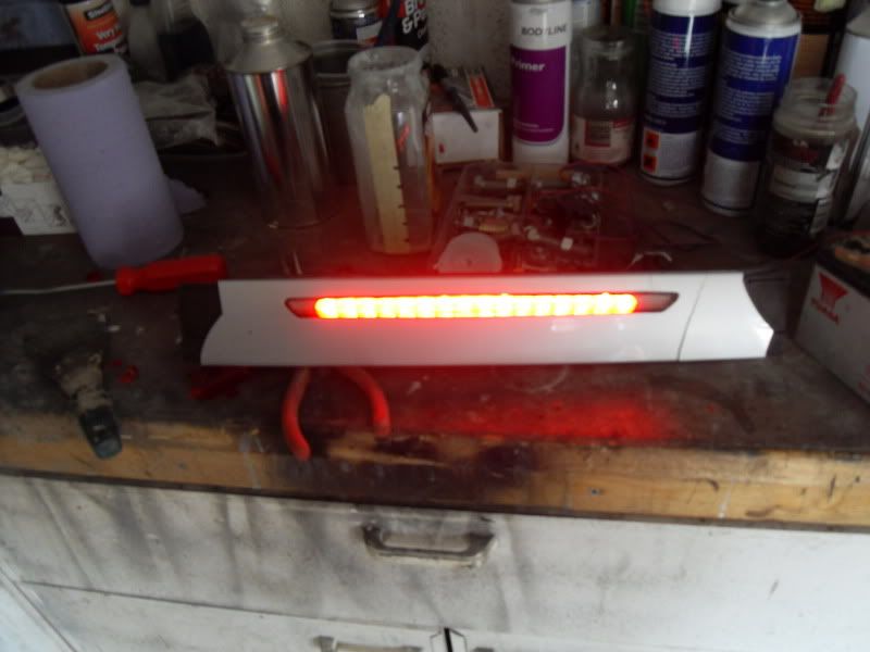

Looks far better than those poxy bulbs IMO but i am on the lookout for a slightly longer one as the led,s don,t go right to the ends with this one
This was a practice run , i just need to do it on a new one costing £100 and is brittle !! lol
That looks smart, and i know what you mean about the crappy hit and miss nissan ones, another job I must do, CheerZ

Never really thought about replacing the four bulbs with leds, kinda had the idea they were satisfactory, must admit though your strip looks very bright.
Some top impressive work indeed - well done that man :cool3:
