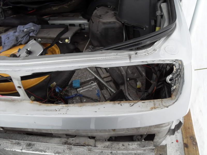

Finally rebuilt my lamp panels

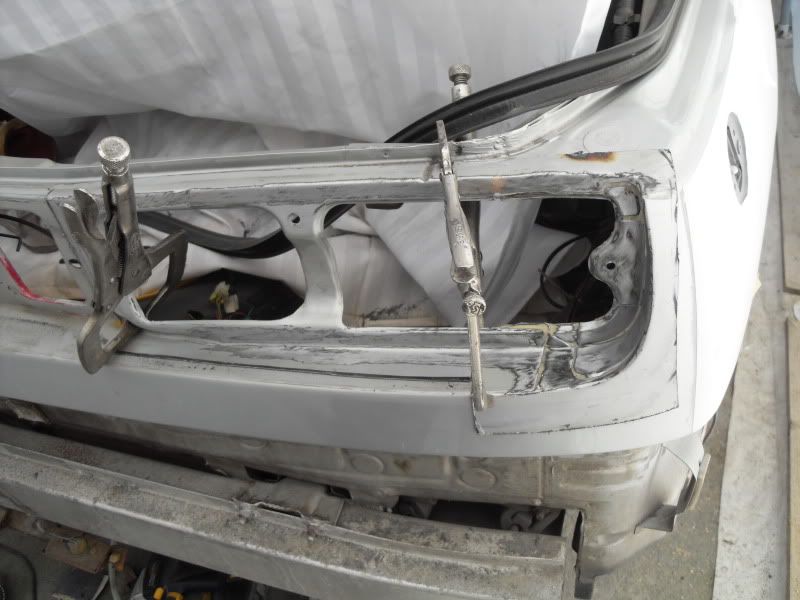

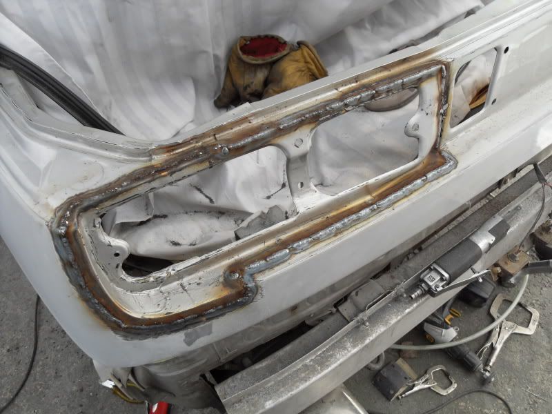

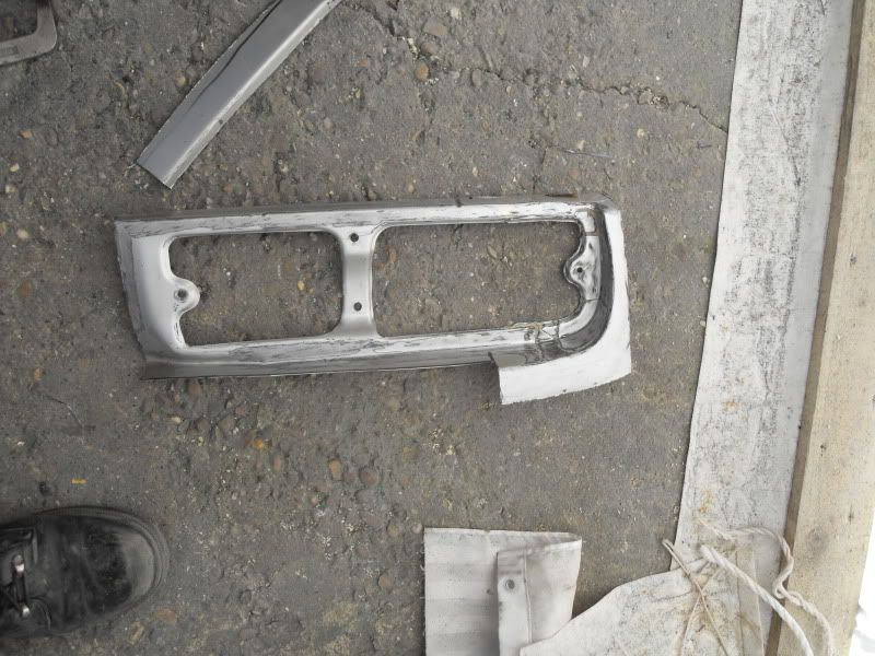

It was the last bit of welding i needed to do , i fitted this a few years back but had to remove a fair bit of the lamp panels to do so
But i want to go back to the standard style so using some cut off a scrapper i had to make good what i,d hacked off previously :blushing:
So after a bit of trimming and fettling i got the new ones welded in

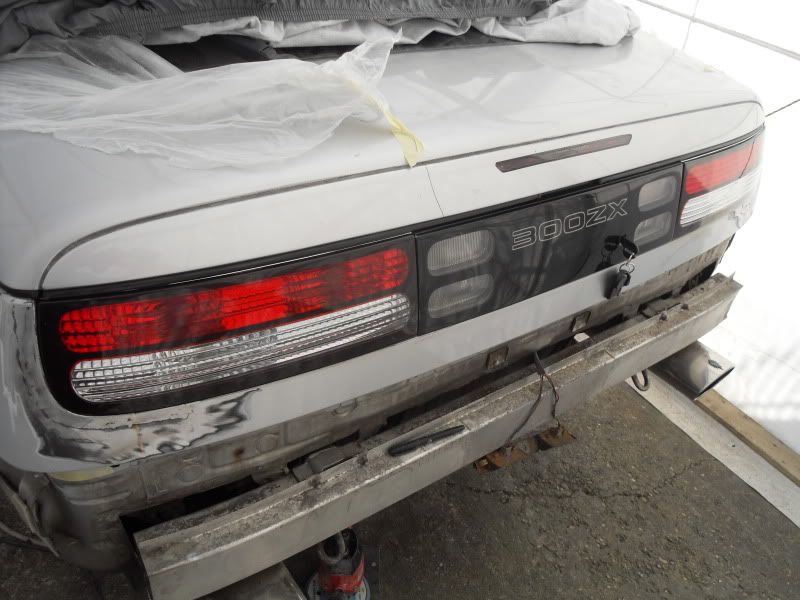

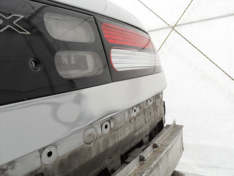

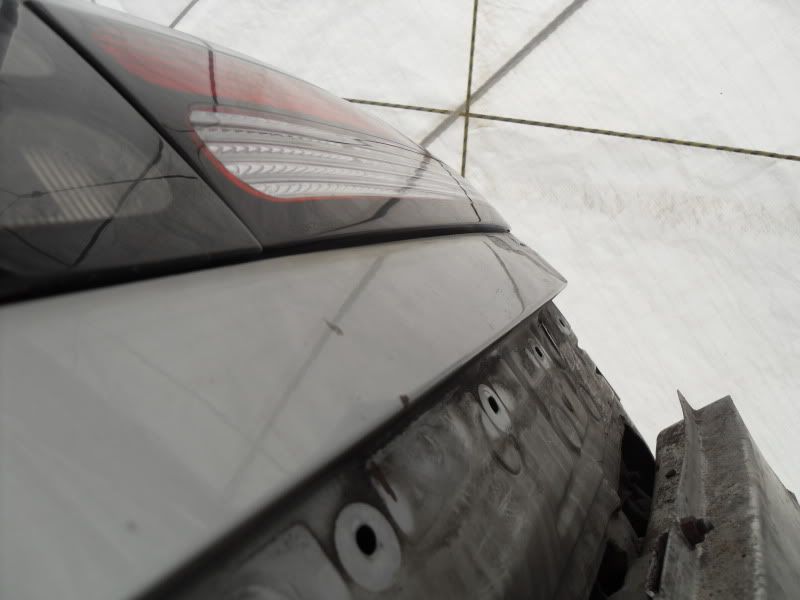

I,m fitting the crystal lights from America and a few,s mentioned that they don,t fit quite right

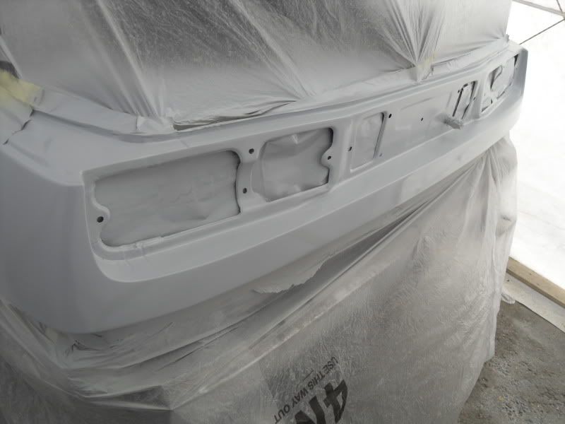

They curve more than a standard light so if they line up at each end the middle sticks out too far !! the only way to make it look right was to build out the rear panel a bit in these areas . This is before .
and after
Looks a bit better , you cant tell now it,s in primer
