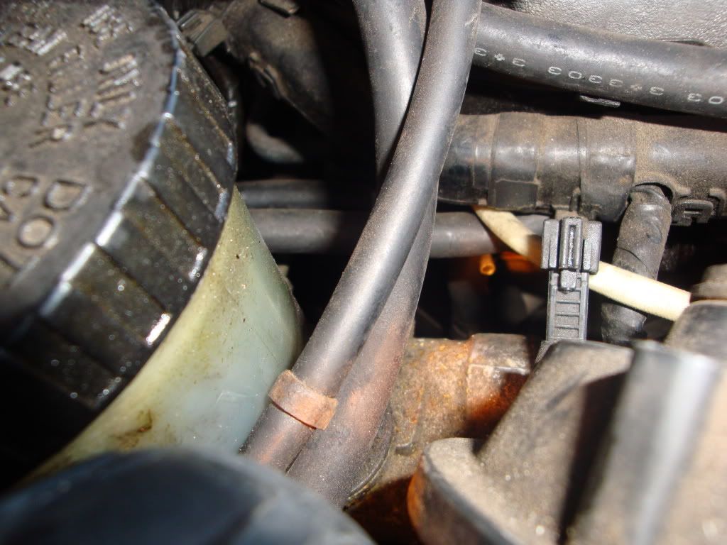

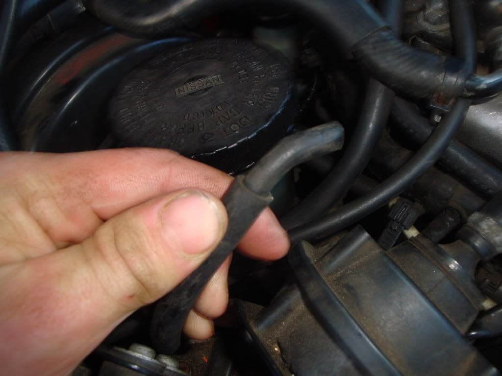

I noticed a vacum pipe off today, just wondered were it goes and whats it for pics below.

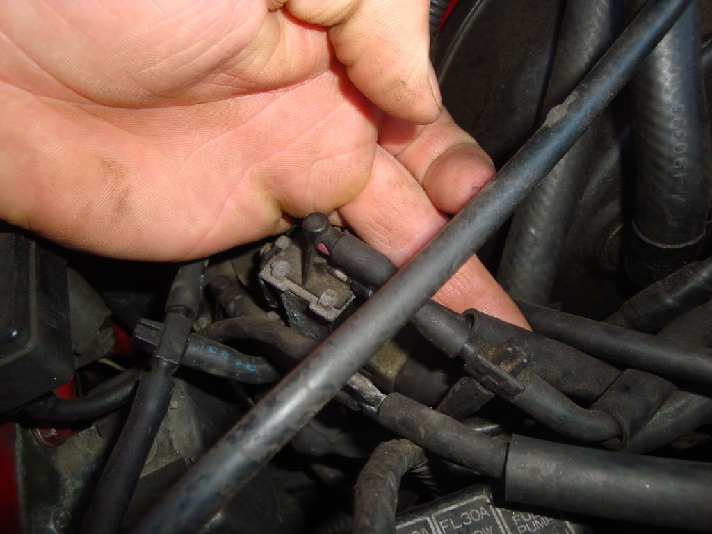

does it go here, found a little tube, which a pipe could go on.
Also daft question were is the gearbox dipstick to check the oil lol, that many pipes to look past.
Cheers Mark
dont know if the pics are any good if you need more let me know
first, cant quite make out where that pipe is going or where its coming from as the camera is too close.
Also, if you have a manual then you wont have a gear box dipstick. only the autos do. and its located almost where your hand is but slightly back abit.
I can see it, and i would say yes, that's where it goes (kind of centre of the pic, a bit orangey)...

also for people who know what is the pipe for and will it cause damage been off as I have just got the car so dont know how long its been off.

doubt it would cause harm, but might leave you in safety boost mode. id suggest reconnecting it to be honest.
I am Vods but just wanted to know that it belong there before I attach it and do more harm lol, cheers bud.
Mark
iirc it's the little extension bar from your EGR valve. The pipe runs from the top of the egr to a hard line on the back of the plenum and then onto the egr Solenoid.
cheers will have a look tommorrow mate.
