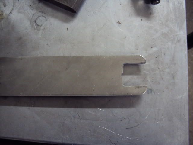

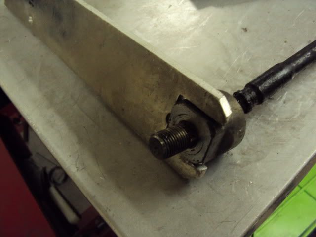

Done this job not to long ago. I made up a thin spanner out of 4mm steel to lock up the shaft on the power cylinder and then loosened of the inner sockets with a regular spanner. I can find out the sizes you need if you want matey.

Here's the spanners i made up to undo the inner sockets from the shaft of the power cylinder.
I made these from 6mm aluminium but if you make them from thinner steel if you want. They are approx 12" long by 65mm wide with a 30mm x 30mm cut out in one end. The idea was that my 30mm spanner was to thick to fit in between the socket and the stops on the power cylinder so instead of grinding down my expensive 30mm snap-on spanner :no: I made two of these job done:thumbup:

that's awesome, always love seeing things others have made, to get the job done.
