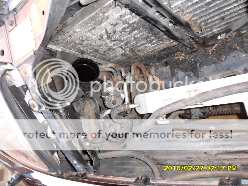

im still struggling! ive got the old valves off, and i think i need some more hose to finnish the job. i just wanted someone to check what im doing is right, ive put the large hose onto the bottom of the dump valve like this SAM_0308.jpg?t=1298817022

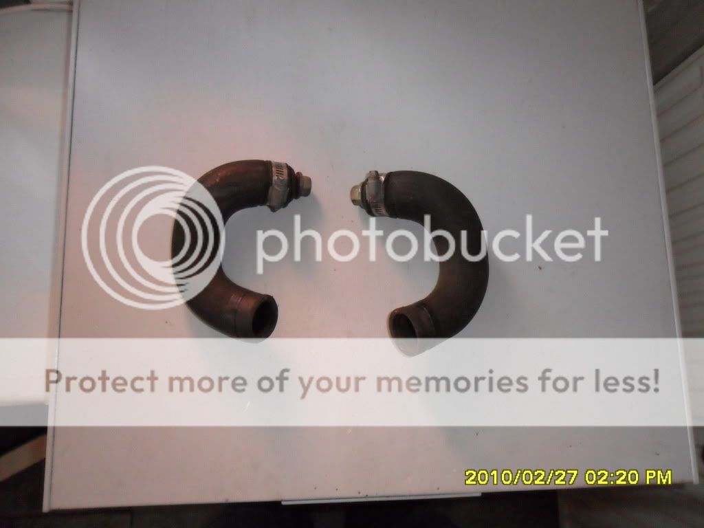

and the im guessing i just need to mount the valve and attatch a longer vaccuum hose to the top of the valve then replace the old intake pipes with these bunged ones. am i right? or miles off lol
