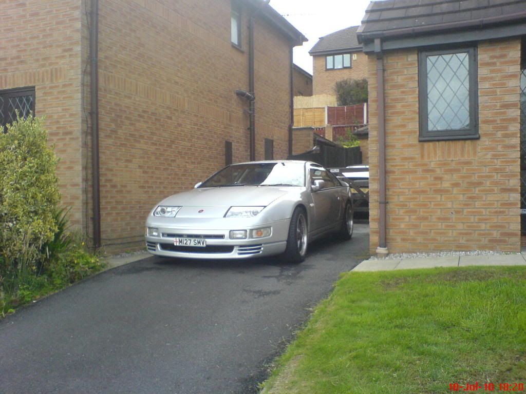

See the pic to compare the size, both are white just the flash as shown up differently
This is the smaller one on an earlier pic- is it really that bad :angry:
