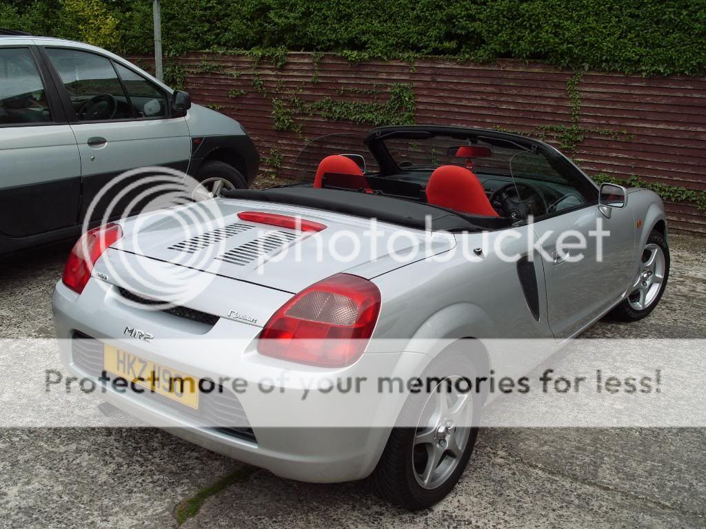

As big jim says the rear brakes are common my wife mr2 roadster had new rear calipers on then a month later it failed the mot on them they needed tightened up and to do it the tension on the handbrake was loosened then the brakes were pumped hard 3 times and the tensioned on the two cables are tightened. By the way ITS FOR SALE.:biggrin:
