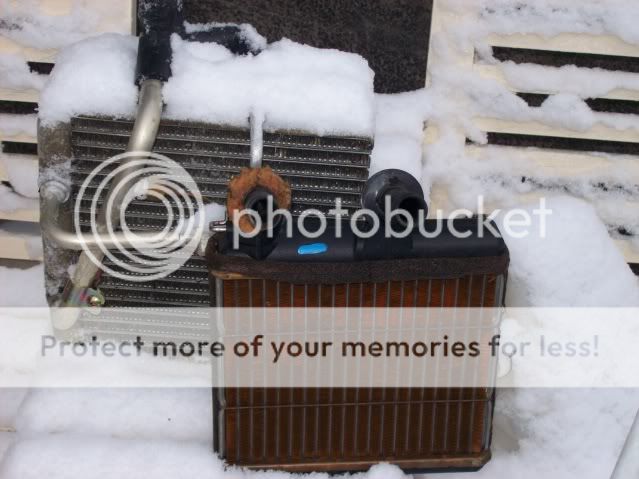

after lee helped me remove my heater matrix i failed to check it now iv actually recieved a replacment one p10 primera the onle thing is it the one with the moulded tank and no flanges
anyhoo im really puzzled as to what matrix i actualy have in my zeed coz this too has no flanges heres the one that i recieved and the one we pulled from me car

Use the ones of your car fella on the P10 matrix thats what I did works a treat
The copper pipes you mean?? should just be 4 screws om each one into the matrix
that aint a 300zx heater matrix or a P10 for that matter
I now see your problem, You need a set of pipes of a dead 300 heater as your not gonna be able to use them.
i know thats why im puzzled what you think the apparent p10 is getting sent back
but coz the pipe works on the one wee pulled is different im not sure what to do
If you have a new P10 matrix keep it, It will fit ive done the same in mine, You just need a set of copper pipes to attach to it from an original 300 matrix
Put a post in the wanted section, for "Copper pipes for heater matrix" I might have a spare set at home somewhere ill check tonight.

The one you have fitted is from an early 300zx Z31
