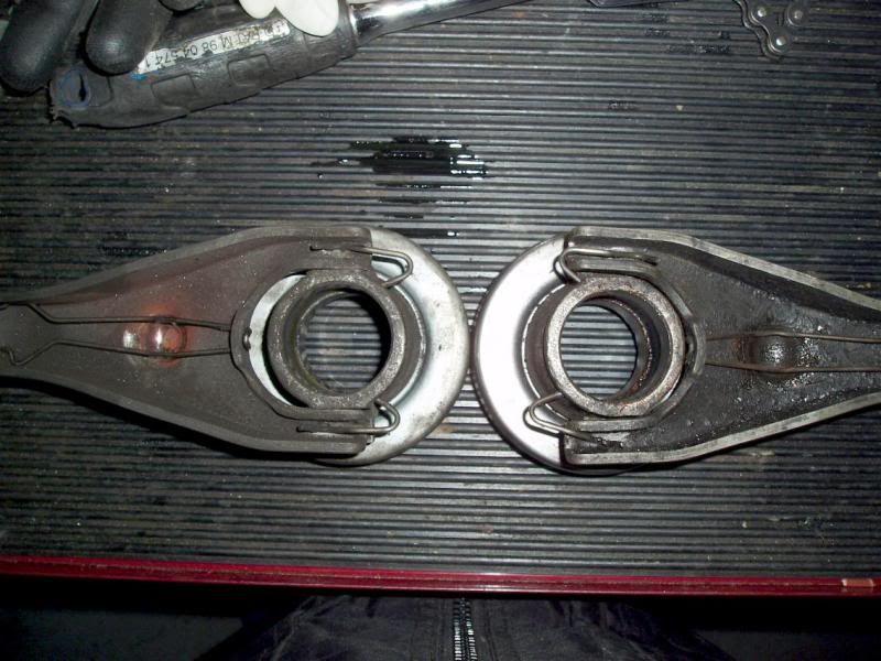

With the zed up in the air the clues to the problem were easy to see, the clutch fork was twisted over and the slave cylinder was very extended, in fact dipping the clutch had very little effect as the fork was so badly positioned, little wonder selecting gears was such an issue.
So the gearbox was dropped and the clutch fork, bearing and bearing carrier was removed, at first look it could be easy to not see a problem if unfamiliar with zeds.

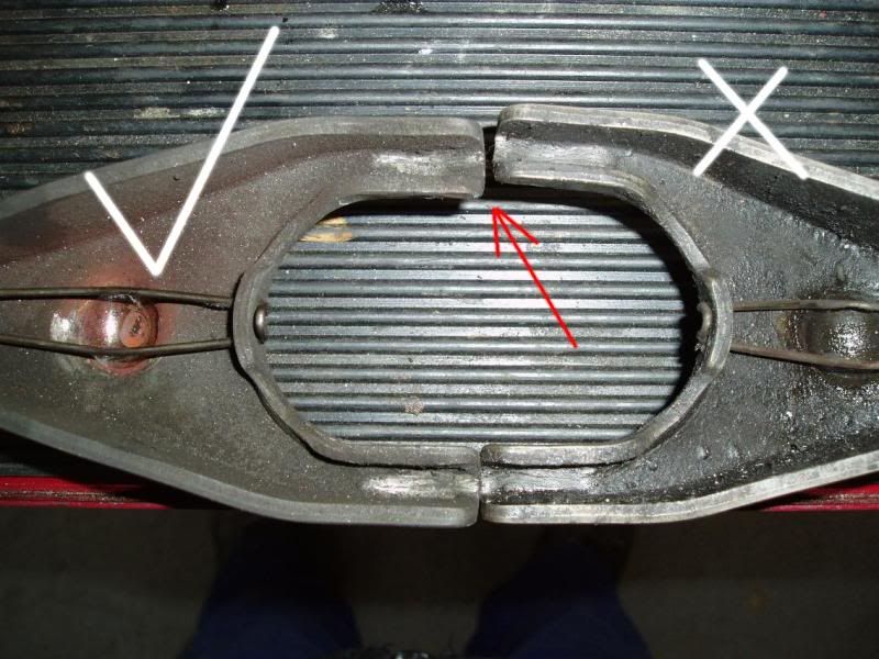

The clutch fork bridge was misshapen to a point where the bearing carrier side shoulders had worn excessively and in turn was allowing the fork to twist enough for the spring retainer to slip off.
See how when compared to a good used one how the fork can turn around the bearing carrier and in the last picture how wide the fork bridge had become, how this damage had occurred is a mystery but surfice to say a new fork and bearing carrier and gearbox refitted all was good again and the grating noise...... GONE! from marks on the clutch cover the fork was just catching the spinning cover due to the twisting action.
