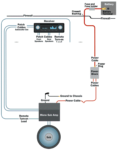

ahh, sorry, my bad, you dont need the power cap, and you can pretty much ignore the middle, i cant seem to find a better pic sorry.
what you need is more like this
amp_wiring_diagram.gif?t=1291147560
the remote turn on lead makes the amp only switch on when the stereo is on, same way the aerial goes up when the radio comes on
