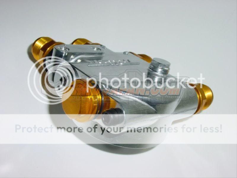

I've fitted an ARC oil cooler off a BNR34 GTR to my 'Z'.

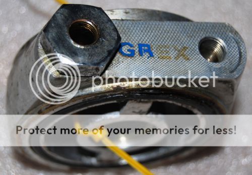

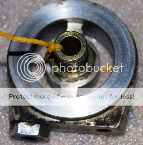

It came with, what I initially thought was a sandwich plate for the oil filter, but having just compared it to the HEL/MOCAL sandwich plate that I bought previously, I now think that the ARC part is for re-locating the oil filter from its original location and not a normal sandwich plate.

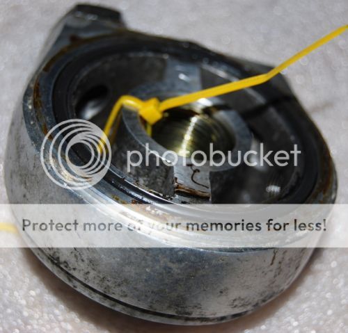

Here's a pic of the HEL/MOCAL sandwich plate

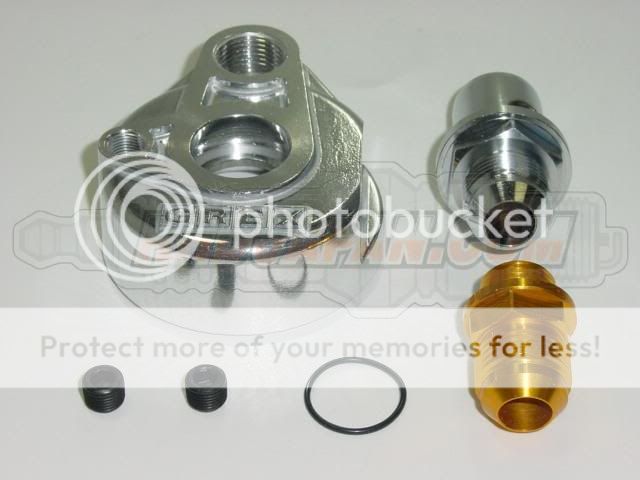

and here's a pic of the ARC part that I believe is for relocating the filter from the stock position
If this is the case then wouldn't a blanking plate with AN ports (if that's the correct terminology) be required also, attaching where the sandwich plate would normally have been fitted?
Yep thats a remote oil filter adaptor, to fit the filter in a more accessable place.

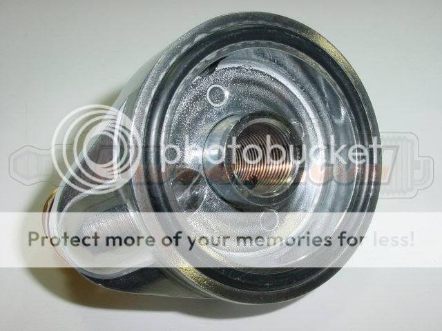

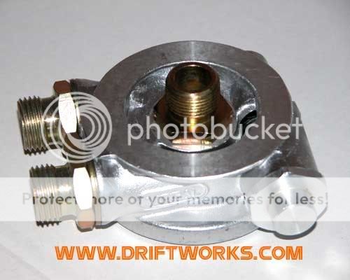

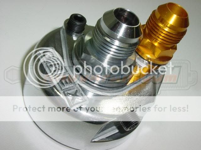

This is the other part of the kit
I guess I'd need this last part and an in line thermostatic in line sensor?
Yes you need two adaptors, one to kake the feed from the block and one to get the filter in the oil line, I take it that is the second picture, I cant see the otherside to check its the filter mount, but i gather it is

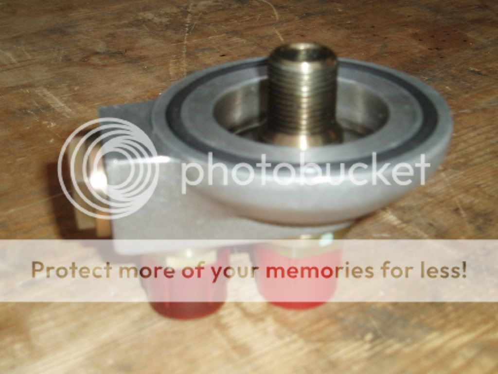

(1) Does this part (below) fit to the block where the oil filter is usually located
(2) and would I then run an AN connectors/braided hose off it.....

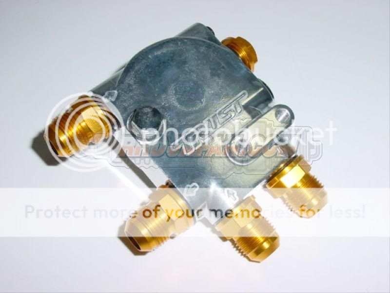

(3) to this part (below) with oil filter fitted, and run AN fitting/braided hose to one side of the oil cooler......
(4) and then run an AN connector/braided hose from the other side of the oil cooler back to the original part attached to the block?

The piece with the ziptie on it is just a sandwich plate to go between stock block mount and filter the have sensors put inbetween.
Ok so no way of running AN connectors off it, just oil temp sensors etc
bugger!
