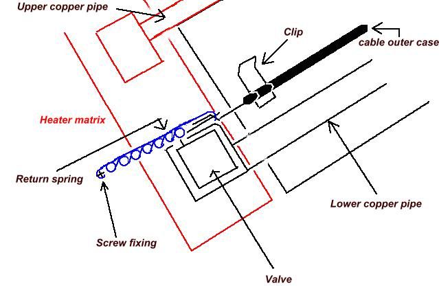

Hi Andy,
Hopefully the quick drawing below shows how it should look.
heatermatrixcable.jpg[/img]
Jeff
jeff on that drawing where does the spring clip too?
Ah yes forgot the spring, hang on will do an edit wait a sec.
Jeff TT
Edited by JeffTT

Here you go.
Jeff TT
Edited by JeffTT
cheers jeff .
its all back together looking like that. on the end of the black cable casing where the clip goes , how much should the black casing go past the clip and where should the valve position be . the clip came off mine during the strip out so just fitted new matrix and clipped back up . is there a starting position , ie valve fully forward and half inch of black casing in front of clip (sort of thing).
Looking at the picture, in the heater matrix removal thread, the brass cover on the end of the cable sits in the clip, akin to brakes on a pushbike, the clip stops the cable moving when the wire inside slides back and forth.
theres nothing on the end of the cable graham . also the metal inside doesnt want to slide in the casing .
looking at that i,d say valve fully forward and about half inch gap from front of casing to clip . cheers graham

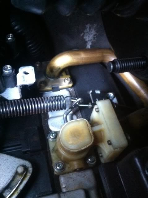

Hello been working on mine today aswell, I took a pic of that part for you incase it helps to see on a right hand drive car:
