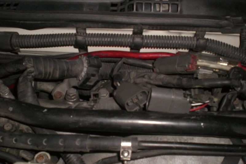

whats this cable under my bonnet for? why is it unplugged?
routine oil check last night and i noticed these two disconnected, they are right up by the bulk head slightly towards the near side, what are they for? why would it be disconnected?

O2 sensor, may be it mistakingly was left unplugged or it could be the sensor has failed and disconnecting is often a better static figure than a corrupted one, only way to know is on a ConZult.

Car has been running fine with this unplugged, as soon as I plugged it back in again tonight I am getting a hesitation at around 2000rpm, unplugged it again and its fine. Do I need a new 02 sensor or could something be at fault at the other end? Cheers, Dan

Sounds like it bud , i,ve ran mine for six years with no o2 sensors at all and it ran spot on . :whistling:

I did once and it wouldn,t run right so i disconnected them and all was well again , as Jeff mentioned it runs on a pre set setting once disconnected and ran well on it so i left it !!
