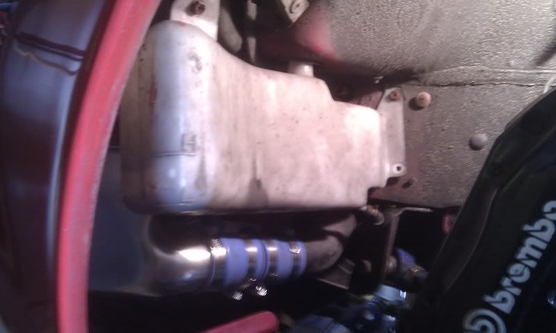

half way through fitting some Greddy SMIC's. Having removed the CC on the passengers side to gain room for the IC I have found on refiting the expansion tank that it's sits slightly further back (only attaches on the top bracket & the top screw to chassis) with the tank sitting at an angle I can see that the arch liner isn't going to go back on. (not that is was on anyway).
Was hoping to get everyting back on as OEM as possible. Shirley the drivers side will be as bad with the washer bottle in the way. Has anyone used/ mounted a smaller expansion tank and smaller washer bottle to overcome this? is so details would be great.

elongating the holes won't help I'afraid Mark, see pic below
The IC pipe forces the exp. tank back at an angle. As you can see I could drill a new hole in the body work for the lower fixing point but the tank is still pissed, which stops the arch liner fitting properly. Look like I will relocate or find a smaller tank to fit the area. How big a catch tank (litres?) did you fit Mark?
