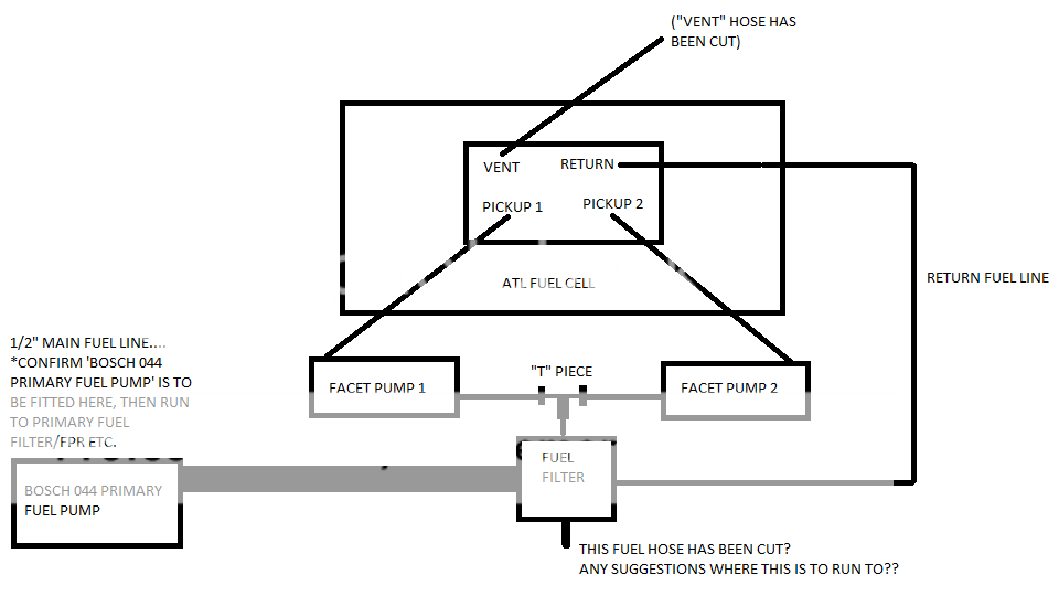

Just wondering if anybody has come across this setup before.
This is an ATL fuel cell that was previously fitted to a Cosworth rally car.
I bought it a while back and am in the process of fitting it and plumbing everything in (hence the hole where my 'Z' used to have a boot floor)
The company ran a twin Facet lifter pump set up running to a large fuel filter.
This 'I believe' filtered fuel to the primary Bosch 044 fuel pump which ran to a primary high flow fuel filter/FPR etc.
The vent hose was cut whilst the cell was being removed from the previous car, as was a second hose that runs from the initial fuel filter.
Any suggestions where to run the vent hose and the second fuel hose??
I was informed that this particular fuel cell is baffled and has an internal swirl pot, however I'm waiting on confirmation from ATL as to whether I actually need to run a separate swirl pot.
(here's a very basic diagram of the layout as I understand it)
