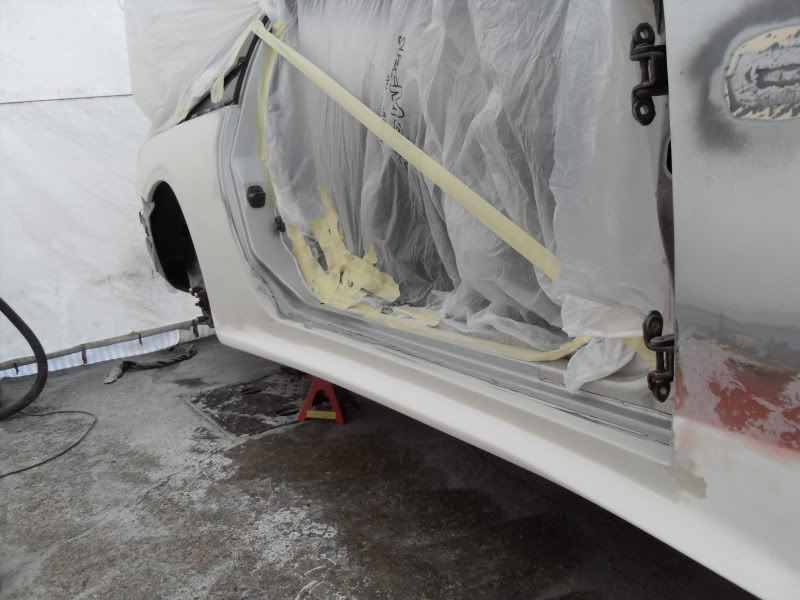

Been filling

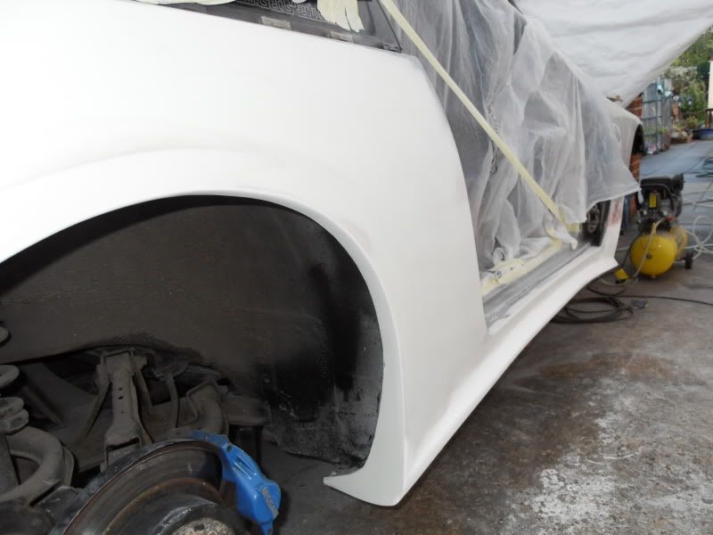

Spent most of the day on my knees rubbing filler down:sweatdrop::sweatdrop: as you can see i,m blending the skirts and the door fillers , gonna try and get the wing done tomorrow so i can get it primed and protected , i love rubbing filler down..NOT.. lol
Once this sides done i can start on the other :crying::crying:

great work mate, cant wait to see that color on the car

Aint' ya done that yet??:tt2:
It is a pity that the skirts don't reach the flanges (like my old ones) would save a lot of hassle!:ninja:
Seriously dude as said today that will look the nads when done!:thumbup1:
I still think you need a t/gate skin tho'!
That looks fantastic, youve obviously got some good skills with bodywork. Am in same process with my side skirts now ,but it doesnt look anything as smooth as you have acheived.
:blushing::blushing: Cheers bud but i,ve been panelbeating for nearly 30 years !
Fook no wonder i feel knackered , must be ready for a break by now ! lol:lol:

Did you grind back the top of the skirts to remove some material or did you fill straight over as is?
I remember you talking to me about doing this at JAE and after seeing the reuslts so far, you made a good choice.

With abilities as good as he's, i wouldnt be surprised. Wish i could get a finish half as good as that.

No Swage!! The best look, make it smooth baby :)
