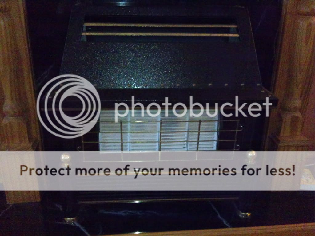

Anyone know anything about gas fires?
does anyone know anything about gas fires? the one in my living room will only work on 1 or 2 (the middle two bars). if you put it on 3 or 4 the whole thing goes out :-( any ideas anyone

cheers :-)
needs cleaning, there is some sooting on the bars which isnt a good thing, possible shimney blockage
i guess it hasn't been serviced for a matter of years/decades lol?
there is 2 jets on the burner, one for the 2 middle and the other for the 2 outers you'll find that jet is blocked

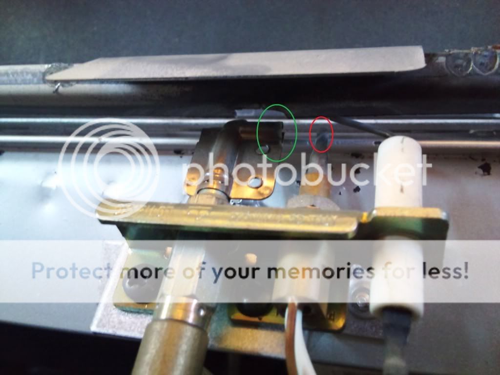

hi guys, and cheers for all the replies. after taking the front off the fire, i found this
DSC_0242.jpg?t=1287924014
the piece circled in green is a little jet which directs a small flame onto the thermo switch which keeps the gas flowing when hot and also ignites the main jets. this stays on on 1 2 and 3 settings, but it goes out when you turn the dial to 4, so inevitably the switch cools down and cuts the supply. any ideas?? cheers in advance
Here is a bit of info on what is going on with your fire, it could well be the exact issue is the fire is shutting down for safety reasons as there is a fault.
Do not attempt to repair your gas fire yourself.
ODS stands for “Oxygen Depletion Sensor" a term which accurately describes this valve type. The valve itself is similar in many ways to the two valve types above...with one exception. The pilot tube is a precision mechanism that creates a very stable flame as long as the room air contains the proper amount of oxygen. If the oxygen level in the room air drops even slightly, the pilot becomes unstable and lifts off of the thermocouple (see diagram) causing the gas valve and appliance to cease operation. This type of valve is very reliable, and there have been very few failures of this system - even with tens of millions in use worldwide.

Given that it is illegal to work on any gas appliance unless qualified its simply not worth the risk to life for an unqualified person to attempt any repair on your fire.
Call in an appropriate registered gas safe engineer, follow the link below for more information on this and where to find a local engineer.
My advise is watch the video in the link...very powerful message.
http://www.gassaferegister.co.uk/learn/true_stories.aspx
Jeff TT
Edited by JeffTT
That's spot on jeff. Do not use this fire again and get it checked by a gas safe registered engineer. Fires can and do kill :no::angel:
