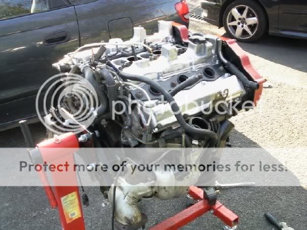

actually, i think that is (or should be) one of the 2 outside brackets that hold the plenum to the block? I see if i can find a pic....
oops
n708486889_1359324_4385.jpg?t=1287491182
I hate that, when some bugger steals your car and leaves the engine there still.....:mad2:
cool thanks Gonzo and Tudor. i wonder if anyone, upon upgrading to an EBC, has either left the stock solenoid there or fabricated a bracket, as it seems a useful thing to have to help clamp down this pipe, especially under increased boost...?
You dont need all these silly brackets just be happy they are gone and saving weight :)
the bracket helps hold the plenum in place but the bolts can be a right ******* to get back in if the bracket is loosened off below and not put back exactly in the right place.They probably couldn't get the bolts back in !
