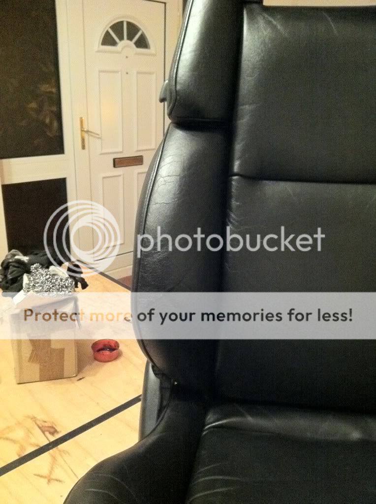

not sure how far you have gone with this as yet but might be rescuable. here is what i did with my worn driver seat last weekend. I did this is a few hours but it ought to take longer really- i rushed it as needed doing - stitch up hole and dye it etc. I will have a full retrim soon. I used the Woolies upholstery kit- designed specifically for leather renovation. comes with a cleaner / hide feed - dye and a sealing paste.
before
after
