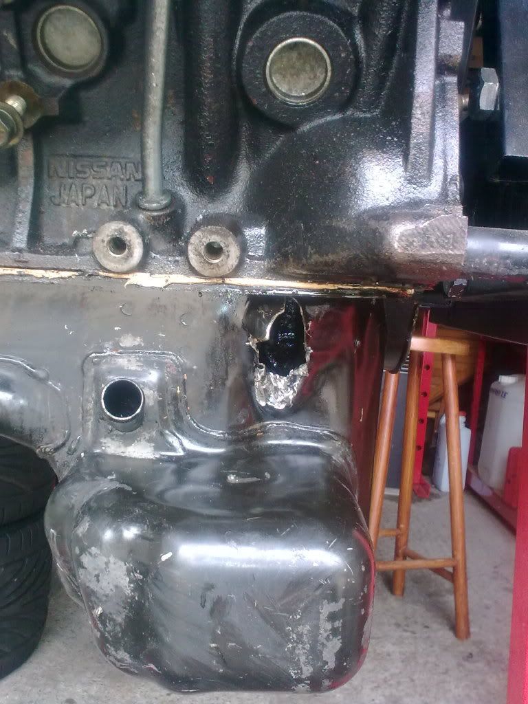

The damage from the last time, 2 conrods failed on my 300zx lol

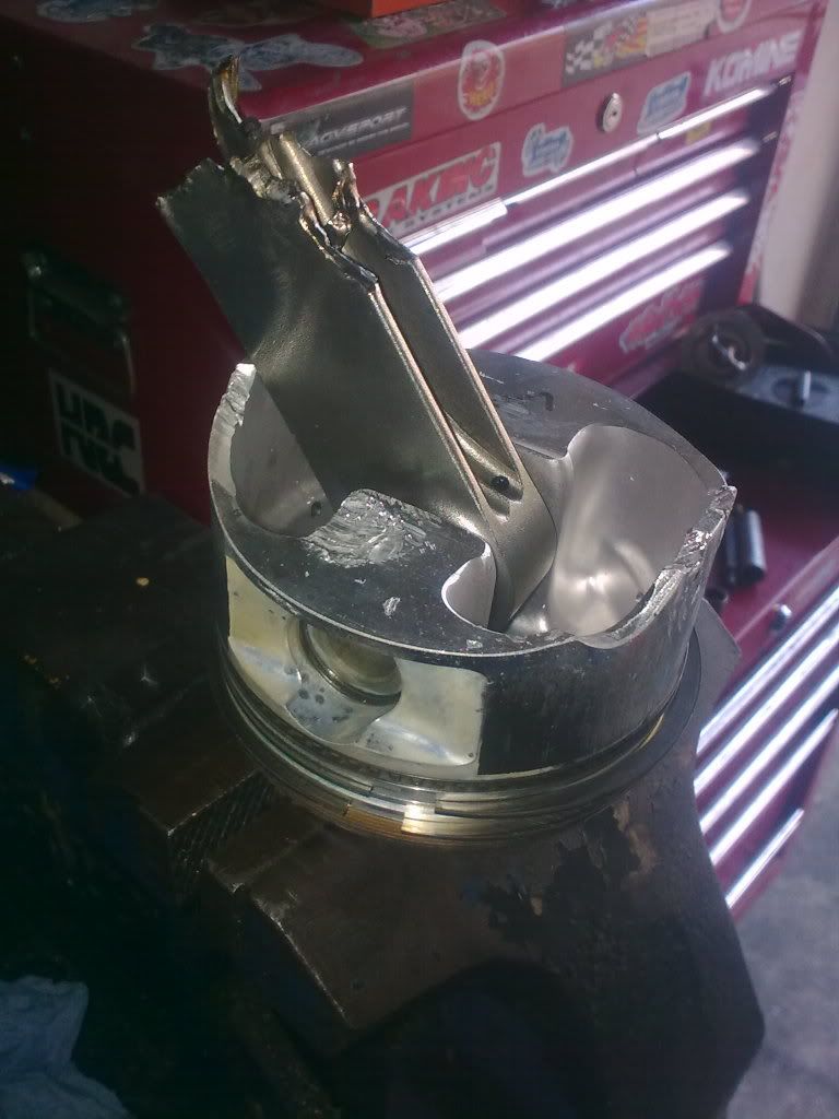

now that pic looks familiar!!!
eagle rod...
lol mark, its like that scene out of jaws where they are comparing scars
Didn't take a photo of the conrods as i couldn't get them out from the side of the block. i cracked the block in 2 locations as well, destroyed half a counter weight and totally mangled that frame that runs around the bottom of the engine that helps hold the crank in place.

The state of that rod mark.

You could, but then the more you up the boost, the more stress as you say, the internals will be under, look at it this way, you have already blown one engine, the pictures of mine were from a N/A with no upgrades, so apart from the odd foot down here or there, not really under any more stress than what it was designed for, yet it still failed. so id definitely uprate the rods if anything.

Haven't got the foggiest lol i bought it with a top end tap, and it was just that, sounded like noisy tappets, that must have developed into a bottom end knock when i was driving around Scotland. next thing you know, crunch and bang, and ala end result, 2 broken con rods lol

Its not the rods that caused the failures in the pictures,The bearings seized,spun in the rod then welded the crank and rod together,the fact that Marks was an eagle rod proves It can happen to any rod,corrillo etc doesnt matter how good it is.The stock rods are not weak and are forged as previously stated.They will withstand 500hp no problem.im running just under this and use the car in anger regular at 18psi and the bottom end is perfect after 400o miles.
exactly that Jimmer, it was the bearing that disintergrated through excessive heat, caused the big end to "rattle" on the crank, snapped a rod bolt and threw the big end out.....
