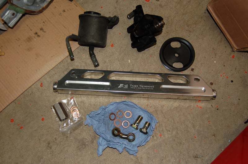

Well I've been buying bits and bobs that are to do with removal of HICAS but I'm really not sure if I need anything else, or got too much... lol :helpsmilie:
Please assist!
So far I have:-
N/A power steering pump
N/A power steering pot
HICAS eliminator bar
Link thing between pipes to remove HICAS unit
various other bits and bobs - unions, washers, blah blah
:helpsmilie: :helpsmilie: :helpsmilie: :helpsmilie: :helpsmilie: :helpsmilie:
Should do it, tho' you won't need the link bit if using a n/a pump cos the pipes won't have oil in them.you can remove the big solenoid as well.
awesome thanks matey, as I said I've just been stockpiling bits without much thought. I wasn't sure what was what. :wack:
Another way to look at is; If you use the fluid bypass pipe I sent you, you don't need an N/A pump or ps pot :whistling:
yeah you can do it in 5 min without all that crap :lol::lol:
Sounds like a plan. About to eliminate my hicas. Got any more of these floating about? Want to make it as simple as poss. Sorry for the hijack :shifty:
All you have to do is cut one of the banjo pipes and join it to your pot and job done,
Don't banjo's have strings?! Think I'll leave it to silverbullett to do mine for me. I can rest assured it will be done right. Wish I had the knowledge you guys posses to do this stuff myself. I'm just lucky to be in a job where I can work weekends to pay for it.
