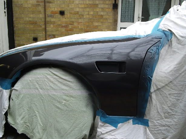

Yup!-rattle canned my wings when I did the vents, 1 can per wing-you will need 2 cans (500ml) for a bumper.

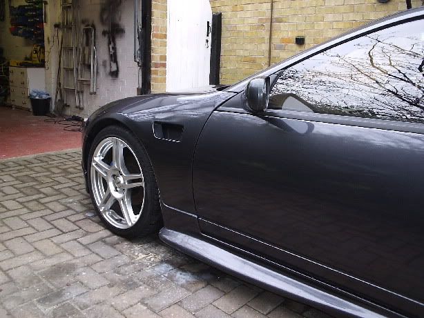

Trick is to put lots of laquer on,thin coats,leave a week and buff the crap out of it!-looks like a proper job.Only pic I can find in the sun is this one........
so did you just dust the paint on then heavy with the laquer then? once the bumper is painted its going to have to dry quick and go back outside,. that looks great btw
You can put the base on quite heavy but even, the laquer needs to be done in several light coats,10 mins between to flash off. I would give the finished thing about an hour before taking outside tho'. HTH.:thumbup1:

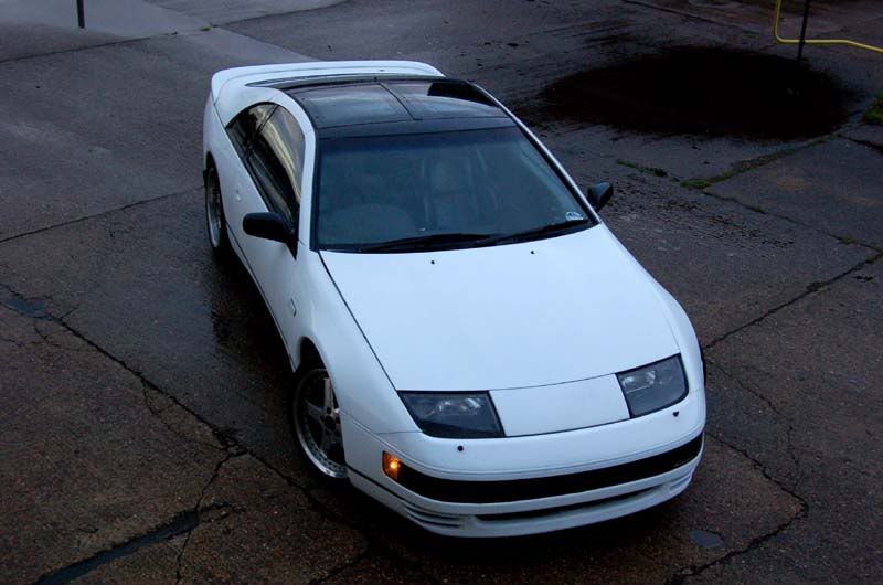

My whole car is rattle-can :thumbup1:
you resprayed it?
that is a nice car :yes:

before:
after:
Looks like it to :lol::lol:
:tt2: :tt2: :gun_bandana:
1 by the looks of things. lol. completly missed the fuel filler. :rofl:
:lol: :asshole:
about 25 iirc

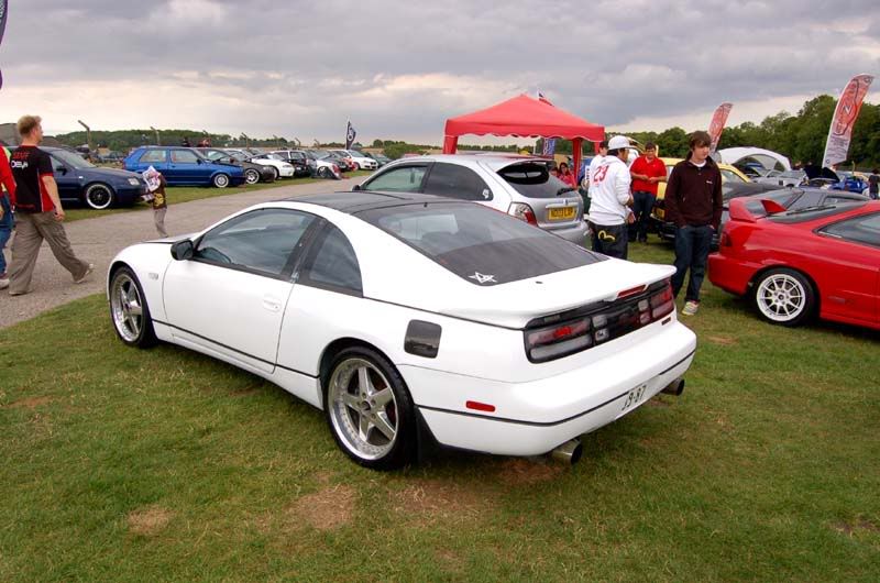

Baz, did you use laquer? Do you flat back the white then laquer over or flat back the white then rubbing compound then laquer?
Once the laquer is on did you flat that back too?
thanks, Tom
I,ve just used rattle cans for the base but two pack laquered on top for the finish , worked a treat .
nice one boldy

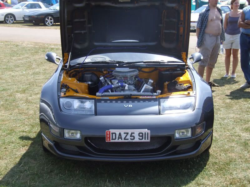

whats with the cutout in the os inner arch
It,s for an aftermarket bling power steering resovoir :cool3:
how many hours did you spend preping that engine bay before painting? i reckon ten hours
It was a fair bit longer in total as i had to deal with all this first :ohmy:
