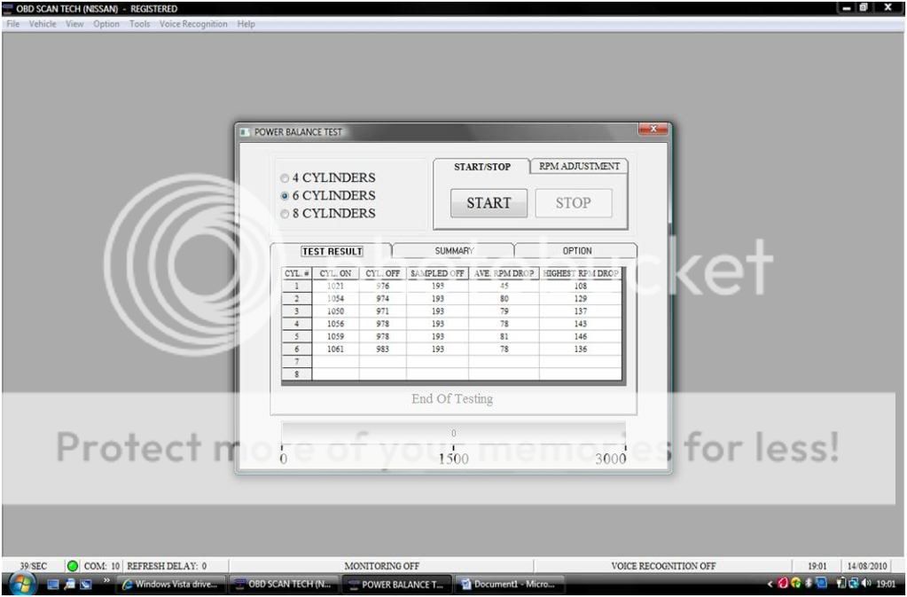

Just had the car sonsulted. These are the figures below on the printout. Can someone explain what they mean? I know nothing about how engines work so keep it simple!! The reason i'm asking is because i'd like to know if i have anything to worry about, or to look out for.

no1 115rpm
no2 111rpm
no3 110rpm
no4 115rpm
no5 127rpm
no6 122rpm.

Your values may be "highest rpm drop" looking at "zed-me-up" posting. If this is correct, then all looks fine to me buddy.

Im pretty sure thats what is mate, ive got the software just waiting on the lead and then try it on mine,i'll post it if you wanted to compare
I have no conzult or software...... but would be good to see the comparison result.

Whats your cars idle speed,those figures are low,id expect them to be higher than that.On average around 200 ish.After ive rebuilt an engine they usually read around 300.
Thanks Jimmer. Does this mean a rebuild!!!! Just looked at the slip, BASE DATA:-
CMPS-RPM 1105rpm
COOLAN TEMP/S 75degC
Does that help? You've got me worried now. Might go out before i get the bad news :confused1:

Thanks zed-me-up. Nice one.Is it therefore safe to assume the figures i quoted are 'highest rpm drop'? If so should i be overly worried? Thanks guys.
