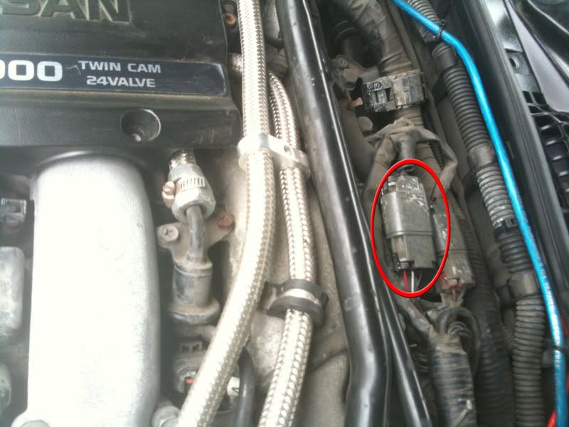

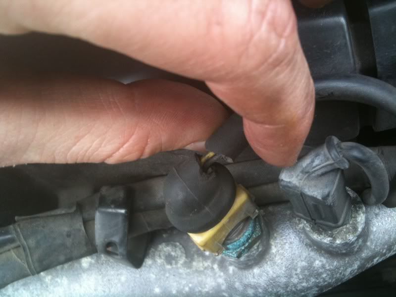

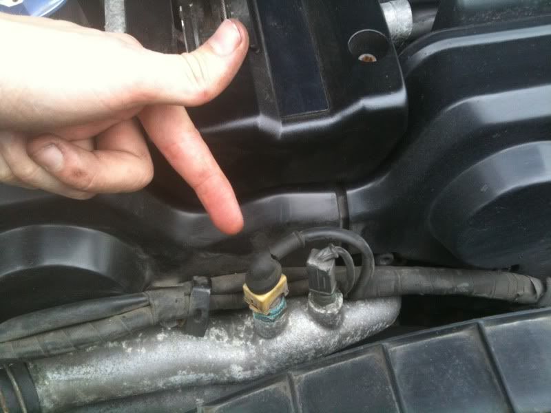

I was giving my engine bay a bit of a clean this afternoon, to make it easier to see exactly where rust is coming through and just to make things look a little cleaner, I noticed a couple of issues one is the wiring going to a sensor I think, water temperature maybe?
I'm not sure what I need to get to fix this, is it possible to get just the connector which I can re-wire?
The second issue I noticed was a plug found by the fuel lines running across the top of the engine, the moulding it has to keep it held onto it's bracket is broken so its all floppy and I just want to replace it really.
Can anyone help me find these parts? or tell me where to look?
So far all I've done is wrap both issues up with electrical tape, but thats only a temporary fix.

The first pic is indeed the water temp sender for the ecu, the one next too it is the sender for the temp gauge. Try Mike at MJP for a replacement. I'm not too sure on the second plug

get along to a scrap yard if your lucky you will find an early type nissan with the same connections and solder them on if not i think it was the ford connections which worked a treat when i did some repairs just need to trim the guide pin off, the second pic is the o2 sensor and a bit of tape or cable tie will help secure it.
