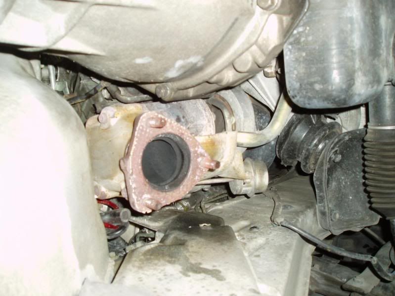

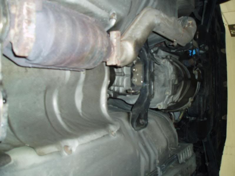

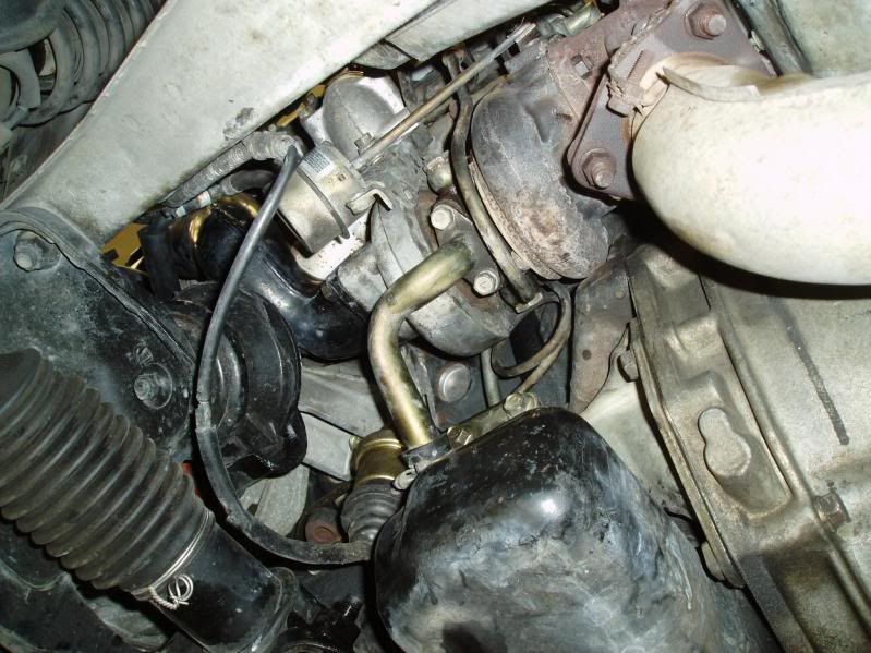

From below the next removal was the near side cat and down pipe

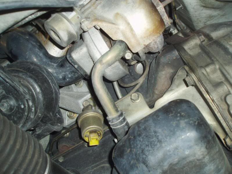

So this revealed the turbo and turbo elbow but little else, still not conclusive but it still looked in this area, following a conversation with the owner we got the go ahead to carry on.

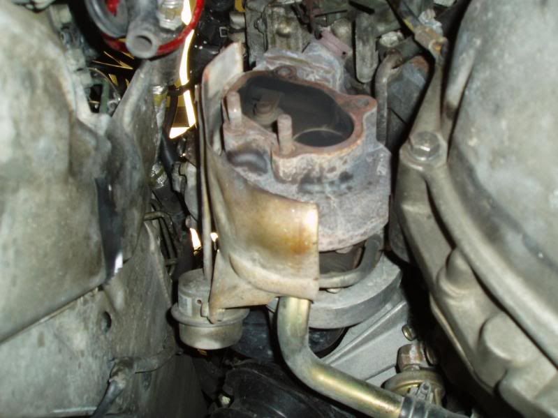

The turbo elbow removed and still all looked as it should

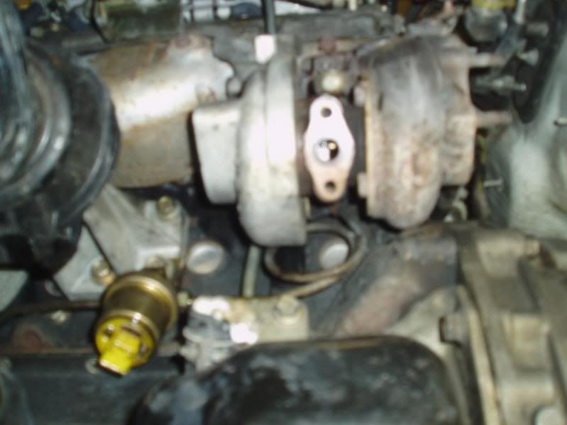

A rear view of the turbo with the elbow removed, nice and dry at least.

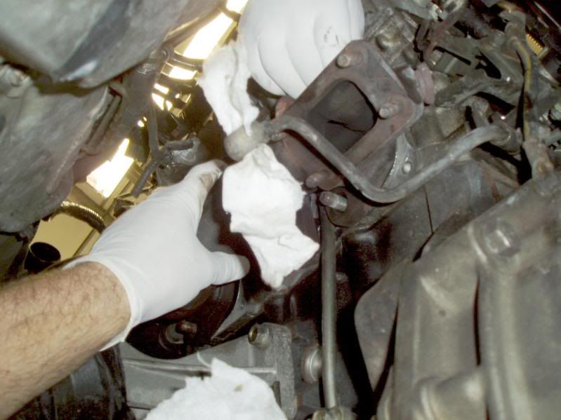

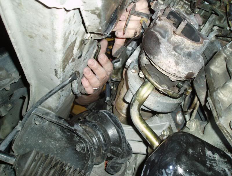

With space at a premium getting at at all of the fixings needs a two handed ( well four ) approach, Jamie working from above whilst I worked from below.

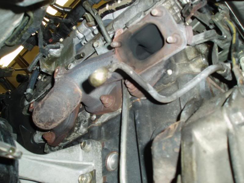

Before you know it all undone and turbo off the manifold

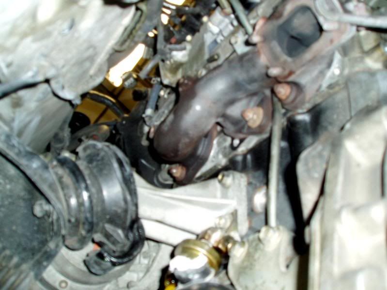

So on to the manifold, lots of WD40 and patience, nobody wants a broken stud now

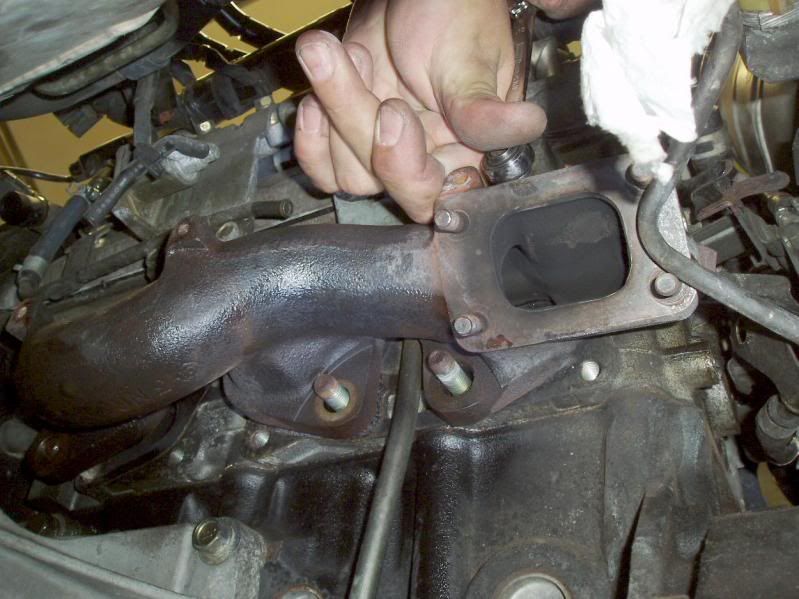

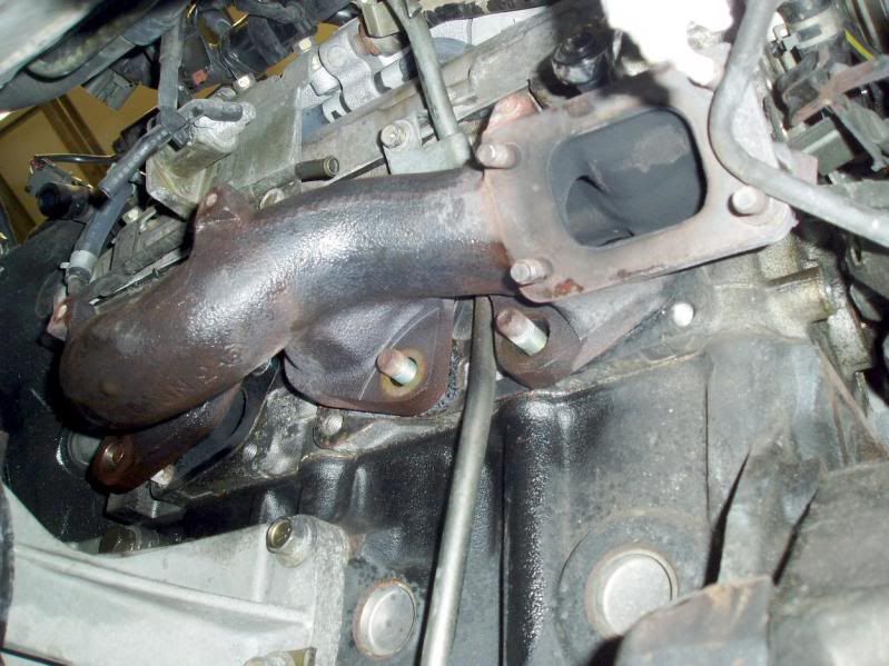

Jamie again from above releasing the final nut,

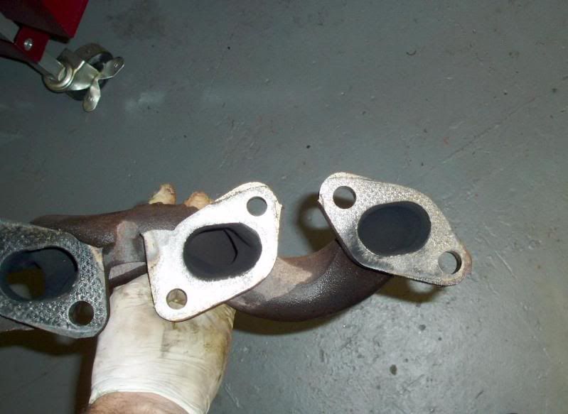

Once removed the manifold tells us we were correct in our diagnosis, the right hand port is blackened from the gasket failure.

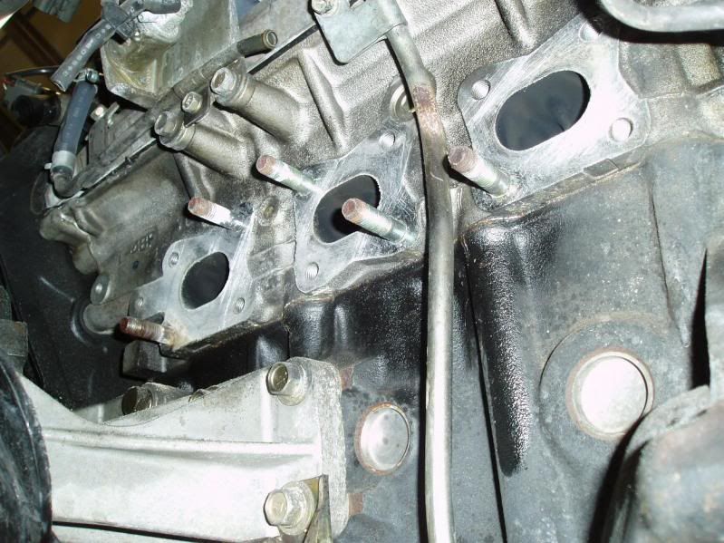

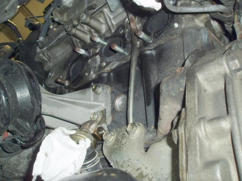

Back to the engine and the head goes further in confirming a failed gasket, the most forward port blacked again.

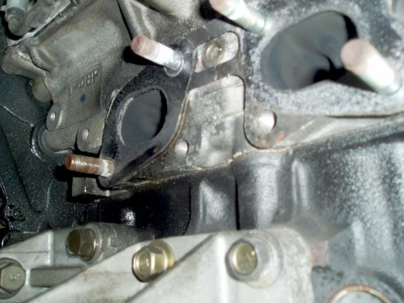

Close up of the head port shows although blackened the gasket is in one piece, the lower stud was the problem, not fully located in the head when the nut was tightened the manifold was not flush against ten head.
Careful cleaning up of the faces ready for and a nice new gasket to be fitted.
