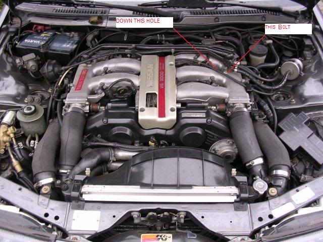

Hey, I was just having a fiddle under the engine bay, having an attempt cleaning up some of the oxidisation on the alluminium intake manifolds on the top.
I unbolted some of the fuel line holders to gain a little more access to the surfaces... and bloody dropped one of the bolts down the gap between one of the manifold bits... and cant bloody find it.. Is this a major issue? is there any moving parts or possibility of causing devistating-engine-destroying-issues?
I need to go to work tomorrow, but im not sure whether I can use the car??
Gutted...
Cheers
Sky
No there is nothing there for it to get snarled up in, it will have dropped onto the lower plenum or behind the fuel rail, no biggy. Get one of those extendable magnet gadgets, it looks like a pen that extends, really handy for these sort of situations.
Yeah i've got one of those, still no success... :mad2:
I've gotten into work this morning with no bolt-exploding-through-the-enginebay situations, however it did seem very tempremental this morning.. burbling and idling all over the place.. driving along seemed to have the same situation, causing the car to buck and judder, but then it just stopped?? Could it possibly been a bit of water combined with ally oxide solution getting somewhere electrical? and then drying out with the heat?
it seems perfectly fine now...?
And I'll check all my fluids and stuff, your right, it is possible that I could have a lacking of PS fluid or something like that.

I doubt very much the bolt had anything to do with it, but whilst ferking about trying to locate it, you may have dislodged/moved a wire to a coil pack or another connector.
I wasnt putting much force into my fumblings... as I say, it seems fine now, i'm going to go home early and see if it all starts ok this journey
