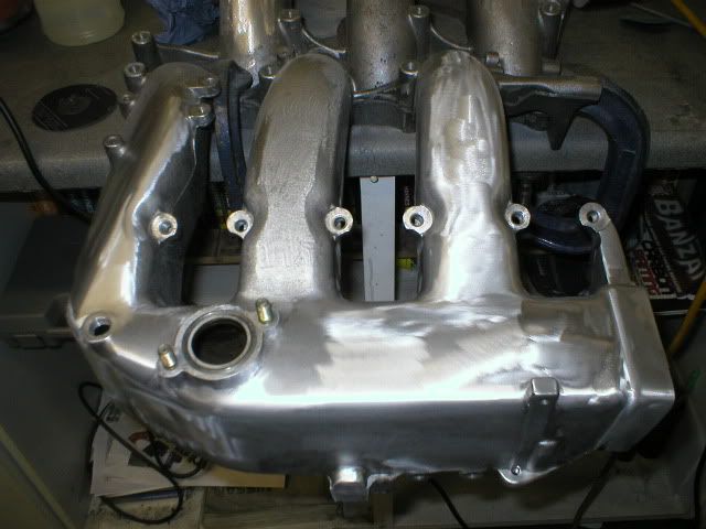

How many Dremels does it take to polish a plenum

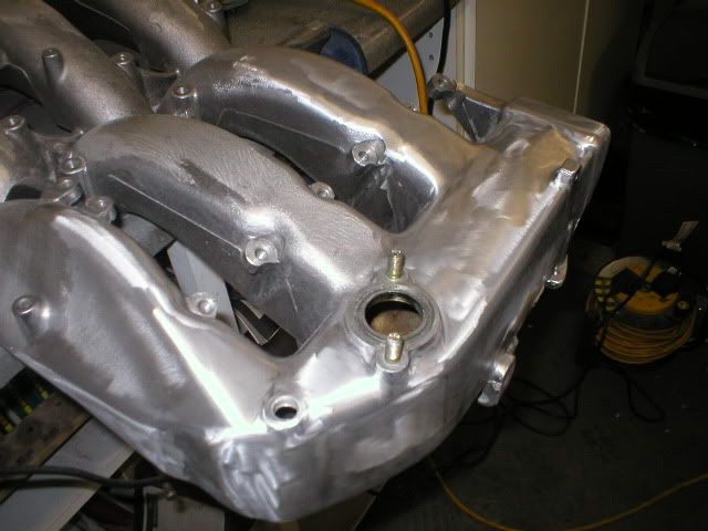

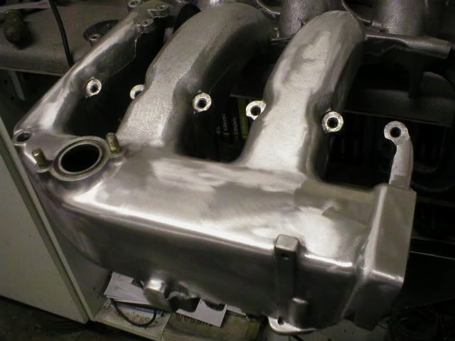

i started with a flapper wheel on a 4" grinderette. That'll get to the majority of rough surface off.
Then i worked down through the different grades of emery cloth.
Yeah you need a drill to do most of it. big job for a little dremal
Like the other guys have said use a grinder with 120 grit sanding disc 4 inch or 6 inch what ever you have. Used that to get out the dimples and casting marks then use a dia grinder with 3 inch and 2 inch sanding disc to get in most of the tight areas then its down to your fingers wrapped in wet and dry to get it smooth enough to start polishing it.
As above, plus, you can buy a dremmel copy with all the bits from maplins for about £20, infact i use that more than my dremmel. And i just bought a polishing kit with all the wheels and compound blocks from Halfords for £16.99.
The dremmel bits are a ridiculous price, i bought a 2pk of fibre wheels and lasted about 5 mins each, so i would forget the dremmel route apart from the little nooks and crannies you cant reach.
