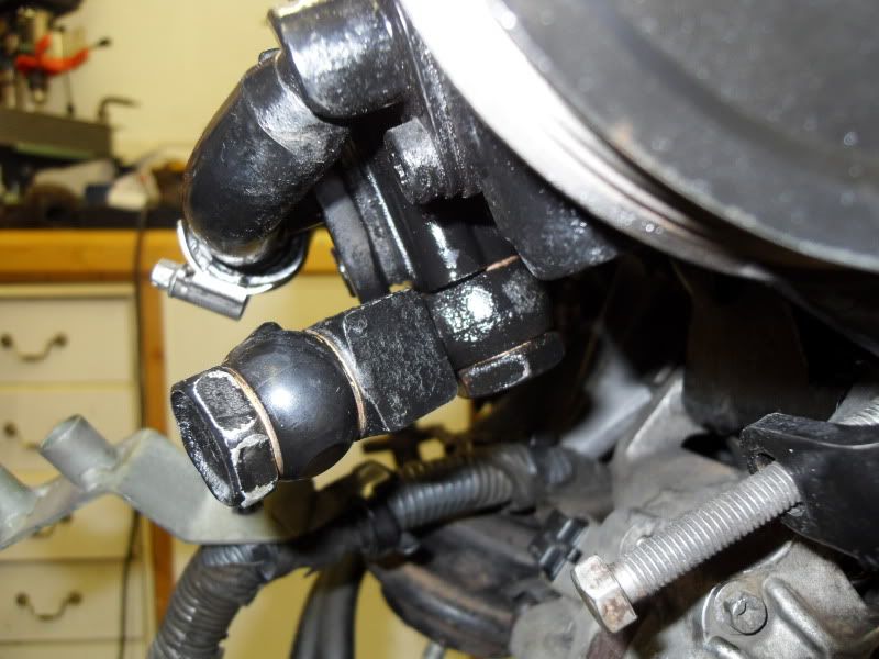

I,ve had a go at my pump today after all the warnings about pressurising a blocked off hicas section of the pump , this is what i,ve found .
After AndyGP had mentioned about removing vanes i thought i,d best open up the pump and have a look.

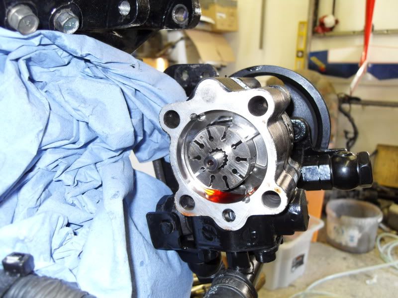

The pump looks to have two seperate sections that work sepearately from each other , front section powering the steering rack and rear section for the Hicas hence why there is a split feed on top of the pump .

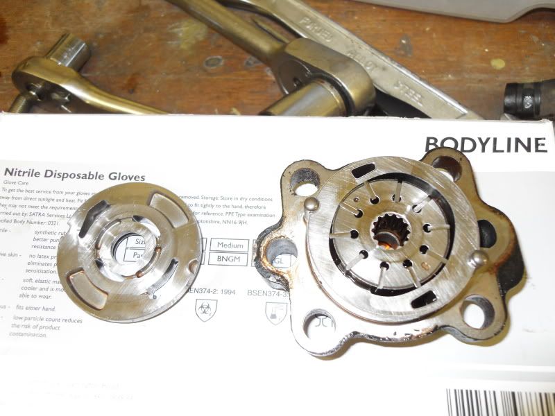

It,s just the rear that needs attention , on previous threads it,s been said to remove the spring and valve which i have done , i then removed the backplate exposing the Hicas oil pump .

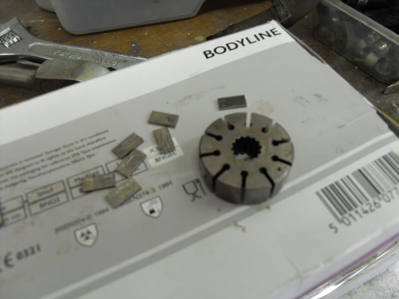

The top plate just lifts off this exposing the pump gear with the vanes in
Lift this out and shake the vanes out , it,s these that pump the oil
Now just put it back together and the rear section wont pump any more

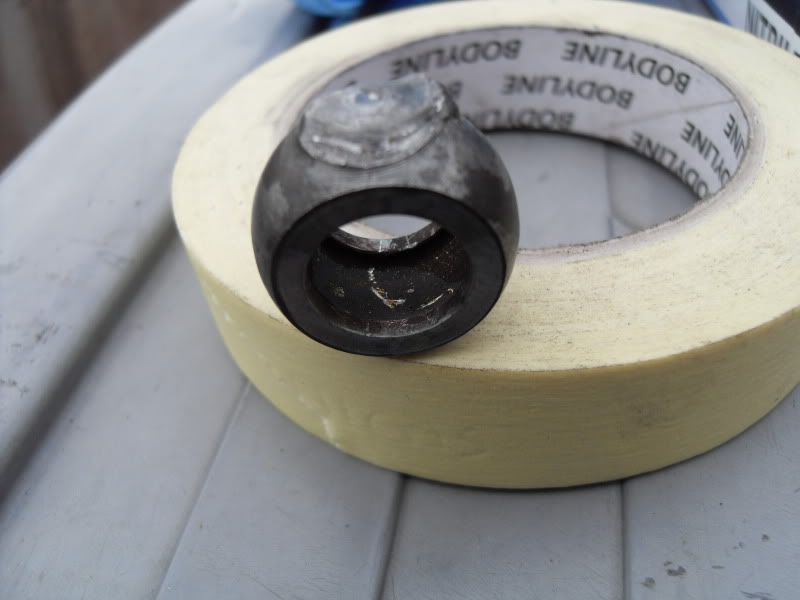

As for blocking the outlet i just used the original banjo fitting , cut it off the pipe and welded up the hole in it .
Hope this might clear up a few things for anyone removing thier Hicas .
