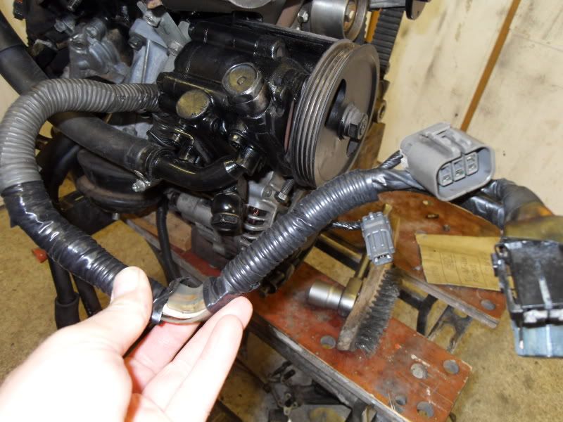

More electrical connectors down by the right hand headlamp. They disappear into the loom and the harness that was plugged into them has been cut. Ive looked on my UK zed and it disappears down by the engine so i cant quite see. Hopefully someone has got their engine out at the moment that can tell me :)

IIRC, the wiring loom that feeds the start motor, then down to the gear box for all the switches / sensors and the like. plugs into these connections.

AH! I havent seen that harness actually now to find a replacement
Goes from those plugs to the alternator then the starter and gearbox , i,ve took a couple of pocs for you bud as my engines out at the mo.
Ah thats smashing thanks alot :)
