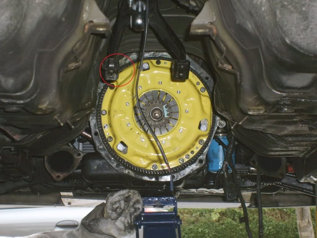

got car back from garage pass window aint working,cut long story short had clutch done awhile ago, took it to another garage and they said earth wire not connected to box thats why hey presto it worked where is the earth on the box? so i can put it back
the gearbox earth strap can be got at from under neath, when looking at the back of the engine, the strap should be on a bolt that goes through the bell housing in roughly the 10 o'clock position. you will need a 14mm socket on an extention, it's a bit tricky but easy enough to do...
