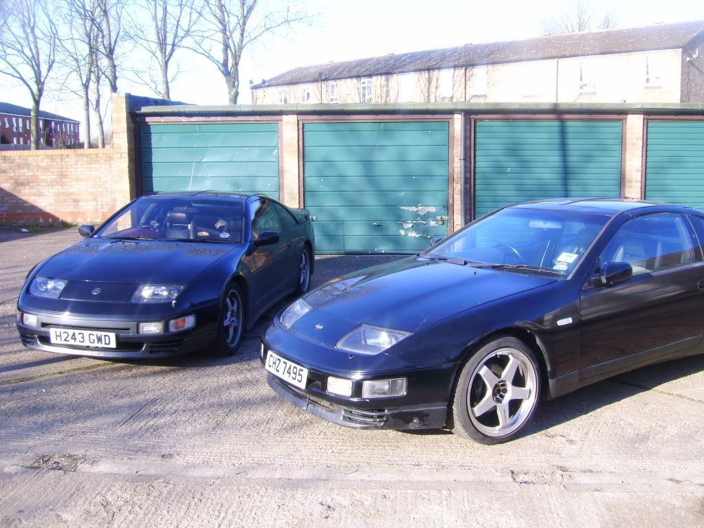

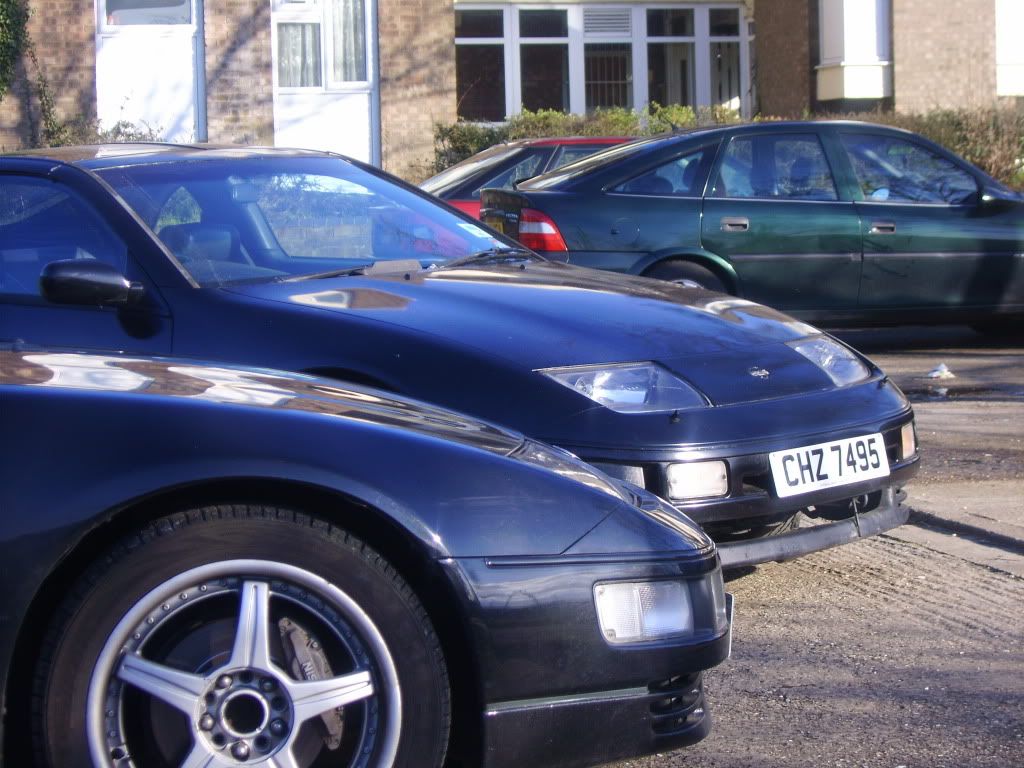

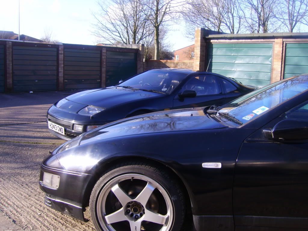

Anyway, as we had both Zeds there and it was a nice day, thought we would get some photos done, so here they are (we were giggling like school kids taking these lol)

Nice work Ian, and its always good to see a couple of zeds posing :lol:
Seriously baz, we were standing there trying to decide on how to park them to get some good shots and grinning from ear to ear lol
Hmm just noticed I still have my passenger side wing mirror folded and my doors not shut...bugger!
:slap: schoolboy errors when it comes to car pictures lol :tt2:

lol baz, was good to put the two zeds together like that, wouldn't mind doing a run with a few zeds to a nice location and getting some good artistic shots to be honest
