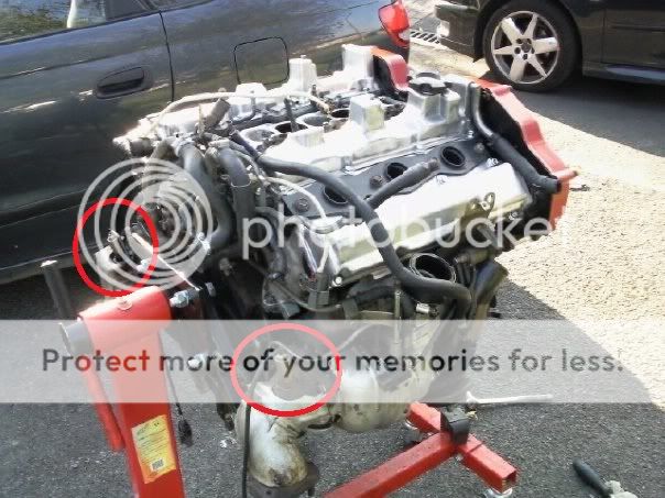

they are both on the turbo elbows, just before the exhaust downpipes join to the turbos, you'll just about see them sticking upwards, bit of a pain to change as they will be seized, you could do with getting it on conzult or something to see how they are working, if they are knackered, you can just break them off, makes it much easier to remove them then...
Here's a picture of my engine, I've circled the sensors for you matey...
