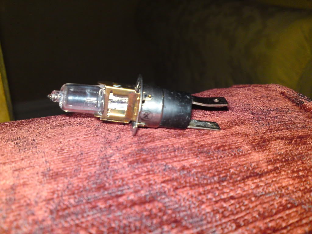

whos awake, i need help, headlight bulb/mainbeam confused
heres a pic of what i pulled from my headlight its nackard and its the mainbeam not the fullbeam, i couldnt find one in halfords :(
both my full beams are working the ones with the 3 connectors on them..... Im really confused, are the jap speak lights different coz im sure in uk the full beam and main beams are on the same bulb? hmmmmmm
If you get the H3 from Halfords you can do the earth mod and it will work, i will try and dig out the thread
ah its ok i bought a pair of h3c bulbs just now from ebay, screw it........
http://www.300zx.co.uk/forums/showthread.php?t=118132&highlight=headlight+bulb
No worries, the H3C are for jap and H3 for UK, but you can get the H3 more easily and you just ground the earth to the screw on the bulb surround
yeah i think the last owner bodged the other side like that bit its so crap coz the light comnes out yellow and so dim..... hopefully these will be better....
