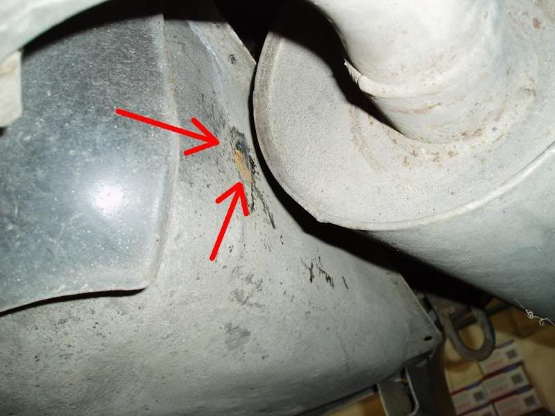

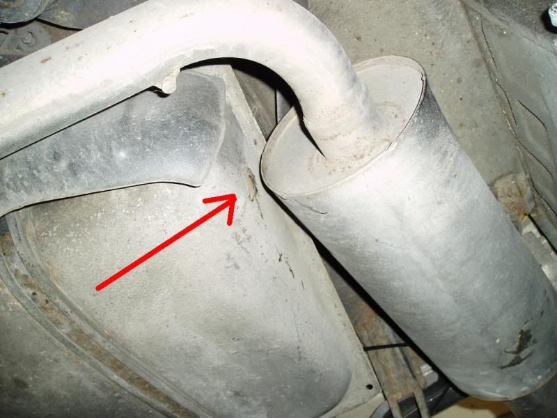

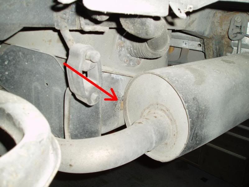

Whilst doing some unrelated checks I noticed the exhaust was touching the petrol tank on the zed pictured below, now it did not look too bad at first but even so a bit of hanger adjusting and there was a nice safe gap, however as you can see on the closer shot the tank where the exhaust box was rubbing was quite concerning and certainly would of been if left for much longer.
Worth checking out any odd knocking sounds under the car sooner rather than later.
