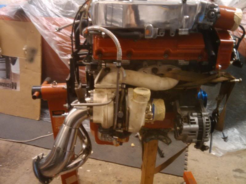

Hi,
Continuing from my previous thread about my water feeds!
Jimmer kindley pointed out that my oil line was to close to my down pipe

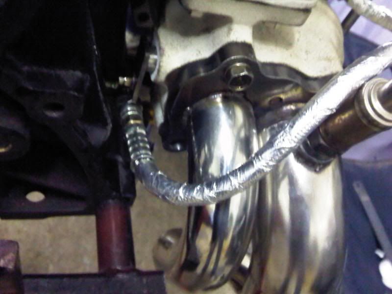

Before.
Since my other thread ive moved my oil line from the down pipe and wrapped it in sticky back heat shield. Should this be enough clearence now?
Also would it be a good idea to heat wrap the down pipe? Ive heard mixed reviews in using the cloth heat wrap.

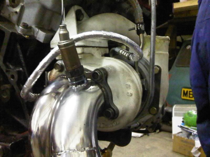

Now.
Cheers
Dan

Just be looking at these pics does not look right to me, would it be better to run the hoses under the turbos?? Would like to know just about to fit mine... or any pics would be nice
Rally cars wrap thier manifolds and so do alot of race cars... i cant think of any downsides to it apart from maybe looks? but can you see them from the outside unless the engines out?
less heat under the bonnet, more heat in the exhaust system= better flow...
I should think any thing that will cut down on the heat transfer and possible cooking the oil in the pipes which could eventually start to clog up lessoning your oil feed to your tubs is a good thing .

As for the ceramic coating and heat wrap ive covered most things that are prone to get very hot including oil lines exhaust and down pipes aswell as the manifolds and turbos. The less heat transfer the better
