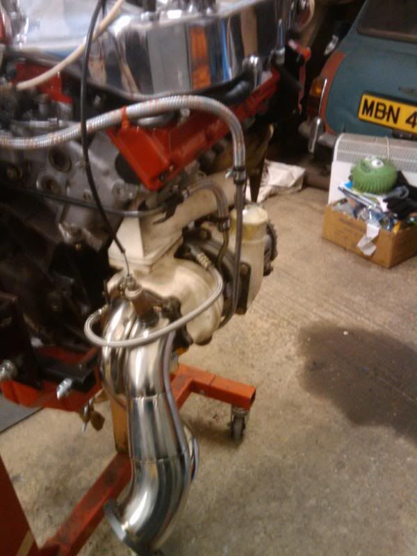

Hi i just want to double check that the water feeds and returns are fitted correctly?

Have i connected the right lines up in this pic or does it not matter which way they go?
Will having the oil line close to the down pipe cause any problems?
Also will i need special high temp bolts for the down pipe?

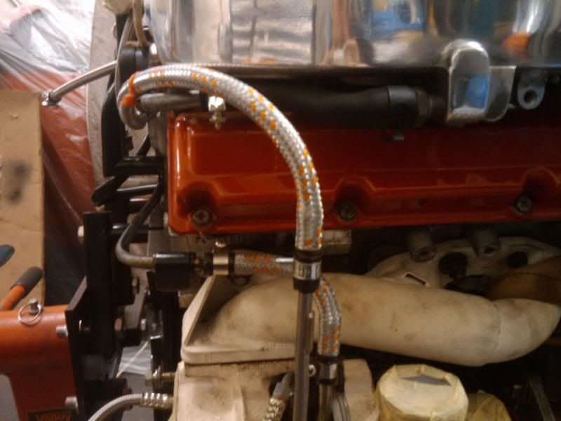

Yea i see the pics that Jeff put up the other day but i cant see where the pipes connect to on the turbo side :(
The water pipes look good but that oil line doesnt.Way to close to the downpipe.Will it not reach if you route it underneath? Standard bolts are fine on the downpipe.
Just about to replace all my pipes, whats the best way to run oil pipes to the turbo then?
Thanks Jimmer,
Ill try and relocate the oil line under the down pipe! Does it matter as much if the line is to close to the rear of the turbo?
