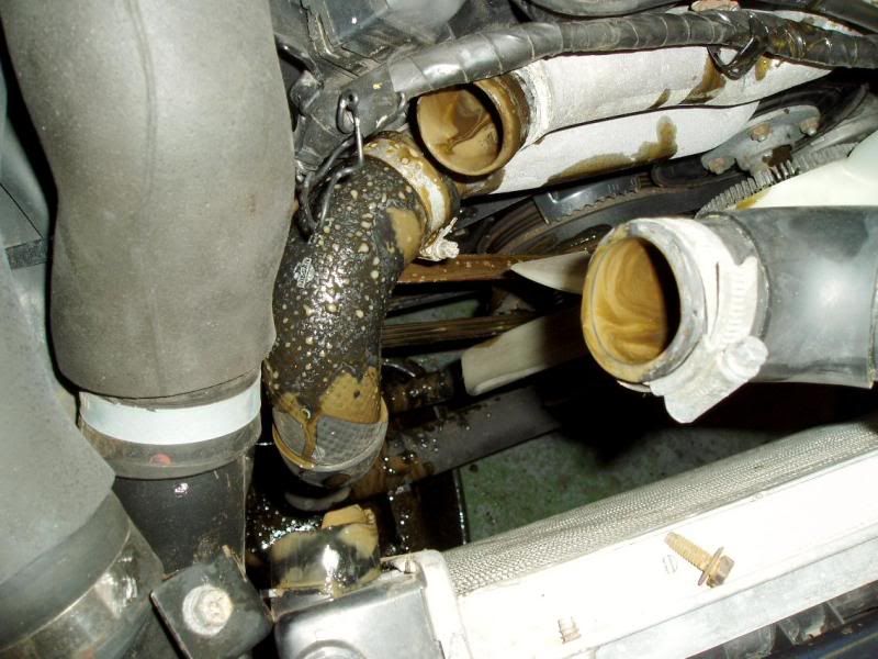

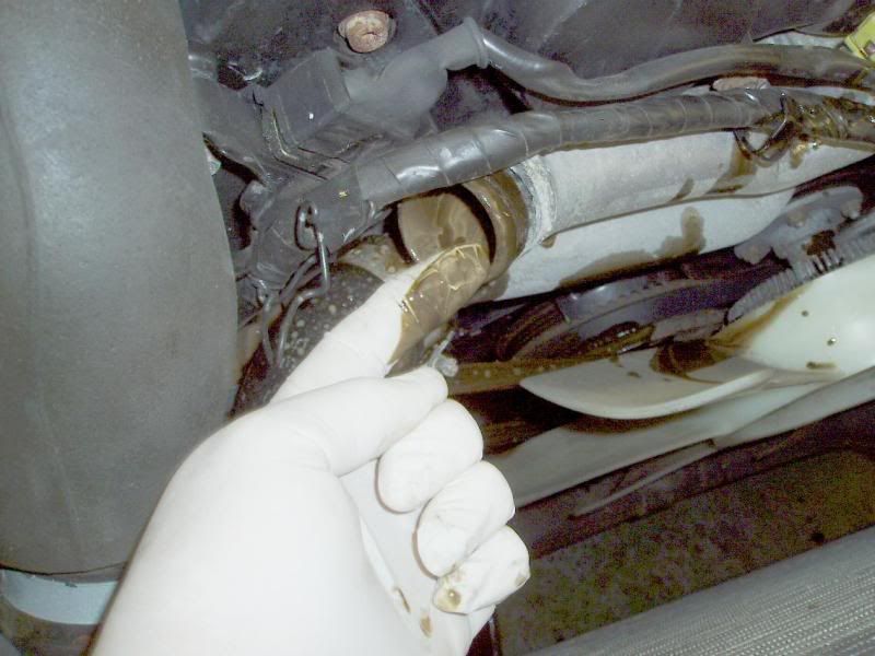

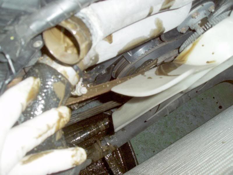

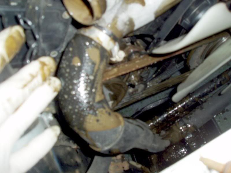

Tasked with fitting a missing fan shroud the radiator top hose was removed but unfortunately instead of a nice water/ antifreeze mix running out this is what did, got to say it does not look good eh?

Odd it seems to run just fine, some spendS required for the future me thinks.

The photo`s do not really show but its oil and water mixed slippy a hell and smells of burnt oil.
