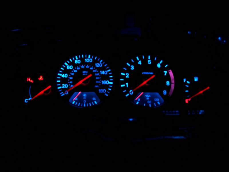

Yes Dave, i find that just replacing the 4 bulbs with 5way leds doesnt give an even enough finish, couple of dark spots around the top of the speedo and rev dials.
So i use some led strips, virtually underneath each of the 2 offending clocks, add a bit of reflective tape here and there and job done.
Heres a pic of mine in blue. I added acouple of red leds at the temp Hot symbol and the fuel empty, just to see how it turned out. Bit more fiddly highlighting certain symbols, but a overall a more even effect with the blue coverage

If you mean the red in the rev dial, believe me ive tried several ways of getting that little sucker to light up red, but the dial face has a blueish coating and it doesnt look that great. If you stick a led directly on the dial face, you see the spot of the led, so it needs to be off the face slightly. The only trouble then is that not enough red comes through to give the required effect

you will need to take the rev and speedo out, hot glue the strip in and wire to the 2 screws at the bottom of the dash to light. I use 2 strips so i can get the circular angle in the right place.
I dont mind doing them, but if you want to give it a go yourself, i can do some instructions for you to follow.
